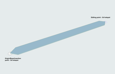

What I in effect want is to be able to define a 'slab' which will rotate in 3d (or 'tilt') when I move the editing hotspot in the z axis, so it looks something like this:
Without the circles and labels obviously.

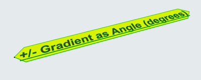

The 3D text will be in a similar position to the 2D text if things work out - but inclined in the plane of the arrow. I want the 2D and 3D appearance to be ostensibly the same.

So in effect the profile I have drawn to create the tube would be extruded vertically I guess - makes sense, because if I have a 3D hotspot at either end of the profile, once one is at a different Z height, the geometry should resolve itself.
Unfortunately that's the only thing about the TUBE script that makes sense to me!
I've tried EXTRUDE, PRISM, POLY and SLAB - they all work in the sense of creating the 3D shape, but don't allow me to drag the hotspot in the Z plane.

Jim Allen
Hi Jorge,
Thanks for the assistance, this is what my script created:
This is what yours created:
My shape works fine, it's the inability to move the 3D hotspot in the Z axis, and have the geometry update that's the issue. I don't think the PRISM option is the right one.
David Maudlin's CROOF suggestion, looks like it might work in the way I want, it sounds like a better option. I really don't want to have to script all the trigonometry...
