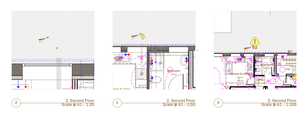

Solution was to remove the MUL2 line and all works as expected
I've been trying this for too long and I'm hoping someone will be able to help.
I've created a 2D warning symbol that I can place on the model, I want it to show as paper size (the same size regardless of the view scale).
I've set "paperToModel = GLOB_SCALE/50" (GLOB_SCALE/1000 makes them too small) which does something, but not quite right. It looks like I need to add "_mm" somewhere but I can't figure out where.
Any help very much appreciated!
