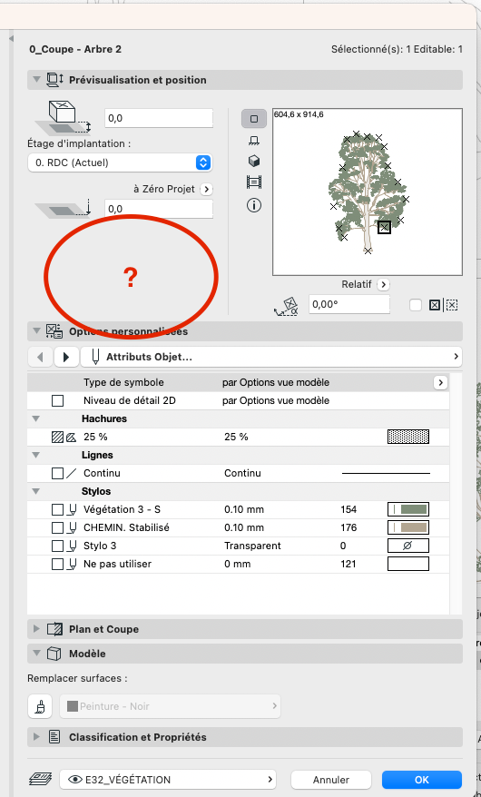

Hi everyone,
I recently draw few 2D plan trees with the library part maker (Archicad 26), witch is an amazing tool. I know there is other ways to create 2D object, but I wanted to get trees that can be simplified depending on the scale and the precision of the project (schematic, low and full resolution).
Once I created the trees, I realized that I couldn't modify the 2d dimensions of it, witch is quite embarrassing. Could somebody help me to fix this problem with or without the GDL skills? 

Pablo68650
Hello!
Thank you for the answer, indeed it supposed to be solved with the 2D script, but as I sayed, I don't have any skills with the script! so here is my tree .gsm.
Thanks a lot!

Pablo68650
Oh yes, my bad, I attached the wrong tree, here is the good one! 😅
Actually, the solution I found was to save the Library part maker object as an object a second time, but it means that I have to keep the library part maker object as a source file, which mean having 2 time more object in my library, and I don't want that haha!

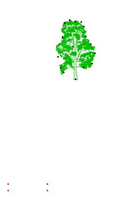

Also, I found the begining of a solution : in the tree you posted in your first answer, I found in the 2D script these lines :
So I copied and pasted them in the beginning of the 2D script of my tree, replaced this :
!these values are coped and pasted from the original A and B in parameters script, they should match the size of the object when not stretched.
mul2 A/3.003683, B/4.402504
by this :
mul2 A/6.046339, B/1
and it created a tree with 4 size points but they are at the wrong place and I cannot modify the size :
So I suppose that these lines are the good one, but I don't know which values I should change to place the size points at the right place!
