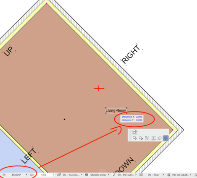

Hi!
I would like to modify the OOTB zone marker. I really like the possibility to have different position for the marker when using the 1/500, 1/100 or 1/200 scale whith the x and y offset.
The problem is that this offset is relative to the rotation of the view and not to an actual displacement in space:
If I offset the mark in my part to the right, and create a second view with a 90° rotation, the mark will end up at the top (or bottom) of the part.
I'd like the position to be fixed.
I've created a simple object (a square + text with positioning managed by a hot spot) that has the desired behavior.
I tried to modify the zone marker. The marker itself has the desired behavior, but the hot spot doesn't really work anymore... Can you help me?
What I tried:
	r = request ("View_Rotangle", "", _angleViewRot)
	hypothenuse=SQR((offsetX^2)+(offsetY^2))
	IF hypothenuse THEN
		TEST2=(offsetX/hypothenuse)
	ELSE
		TEST2=0
	ENDIF
	IF posy>0 THEN
		alpha=ACS(TEST2)+_angleViewRot
	ELSE
		alpha=-ACS(TEST2)+_angleViewRot
	ENDIF
	offsetX =(cos(alpha)*hypothenuse)
	offsetY =(sin(alpha)*hypothenuse)
	ROT2 _angleViewRot
	hotspot2  0, 		offsetY,	unIDoffset, "offsetX_50", 1+128				:	unIDoffset = unIDoffset + 1
	hotspot2 -1, 		offsetY,	unIDoffset, "offsetX_50", 3					:	unIDoffset = unIDoffset + 1
	hotspot2 offsetX, 	offsetY,	unIDoffset, "offsetX_50", 2					:	unIDoffset = unIDoffset + 1
	hotspot2 offsetX,  	0, 			unIDoffset, "offsetY_50", 1+128				:	unIDoffset = unIDoffset + 1
	hotspot2 offsetX, 	-1, 		unIDoffset, "offsetY_50", 3					:	unIDoffset = unIDoffset + 1
	hotspot2 offsetX, 	offsetY,	unIDoffset, "offsetY_50", 2					:	unIDoffset = unIDoffset + 1
	DEL 1

Peter Baksa
there is an option for zone stamps to rotate with the model:
If that doesn't solve your problem:
hotspots work in the transformed coordinate system, you don't need to recalculate their positions.
! show model x, y, axes
line2 0,0,1,0
line2 0,0,0,1
! undo view rotation
ROT2 -_angleViewRot
! define hotspots in rotated coordinate system
offsetX					= offsetX_50
offsetY					= offsetY_50
unIDoffset				= 1
! draw in same coordinate system
line2 0,0, offsetX, offsetY
 Zone stamp positioning information is not available for GDL, you can't achieve a solution which works with all possible combination of settings.
