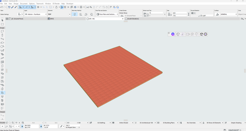

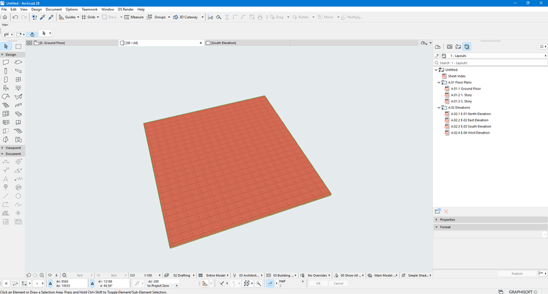

Hello, I have spent a few hours trying to understand why is that an object will show the fill that I defined in Master script on plan view on Archicad 26 and Archicad 27 but not in Archicad 28.
I have searched for new features in Archicad 28 GDL, tried different type of project2 { } options. Nothing works.
I am beginning to believe it may be an Archicad 28 bug.
I created an example object with just the needed code.
In Archicad 26 an 27:
The object's fill shows as a green grid in this image.
On Archicad 28 the same exact object. Can´t get the fill to show.
They will both show a correct texture in 3d.
Any help to solve this problem or Archicad Update to solve this (if it is in fact a bug) would be appreciated.
I am attaching the test object below.
