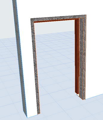

section
3D view

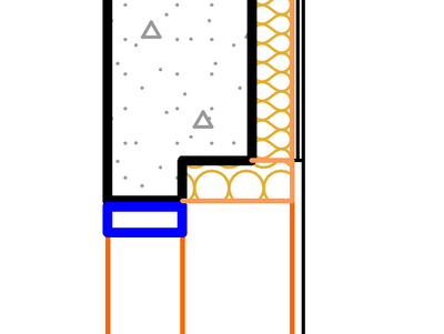

Please make fit to skin available in sect_fill as well.
In Korea, internal insulation is widely used.
So the front door needs to be insulated with cwall_ as shown in the cross section.
However, there is no option to handle fit to skin like WALLBLOCK2{2}.
sorry.
I would like to move this article to the wishes forum.

I did it for subscribers' content for part of Polish distribution held by WSC. There are limitations to straight walls and rectangular openings yet, and the profiled walls report the section in place where the opening is anchored (lintel or sill).

Thank you so much.
What does wsc mean?
You seem to have worked with a profile wall, is that correct?
(I'm not an English speaker...)
I also made a profiled beam or wall.
It can be used in 2D in GDL, but if you still can't use it in 3D, I'm worried that it might not be possible.
what can be done at once
I just hope that they will quickly solve the triple problem of having to adjust the height in the section to install and position the additional wall and also to combine it.

Analyze the wall end tool 😛
That was my starting point.
yet the wall end has the profiled walls disabled in the prossible walls, can be enabled.
However take into account that if the profile changed throughout the part of the wall that the opening is in: it will not sense the change, I have some ideas how to handle the shape, but still none proven yet.
