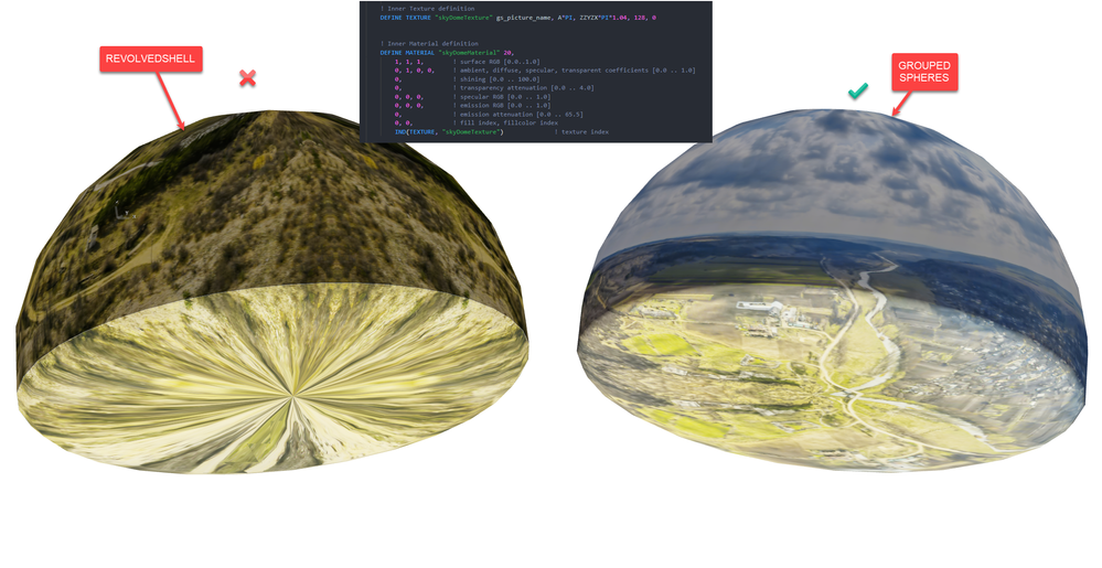

Thanks for that...I should have kept reading the Reference Guide! However, I'm still running into trouble with the texture mapping. I just can't figure out what the secret is. Below are two images of exactly the same texture applied to two different geometries.
On the left is the REVOLVEDSHELL with the texture that doesn't work. On the right is a GROUPED SPHERE that does work. Exactly the same texture definition applied to both.
I've tried a COOR{3} with BODY -1 to see if that has an effect, but doesn't do anything that I can see. This texture stuff in GDL is really light on with the help...
