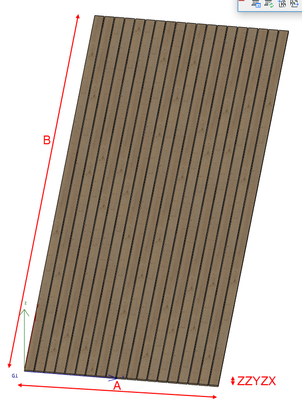

Hello,
I have a simple block using FOR – TO – NEXT to duplicate it, is there a way to add a random texture origin to each duplicated so there is no visible texture repetitions?
Juan.

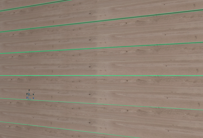

 not saying you guys are wrong but this confuses me as this is the outcome I get using rnd in my loop.
Maybe I can't see it but even when close the planks do not seem to be the same random number

jc4d
I know there is an answer marked as solution, but now that I dig deeper, the less clear this whole thing is.

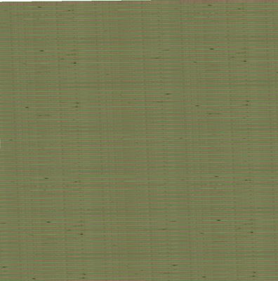

Why the texture becomes randomly rotated if what I set is the origin of it. Maybe my question wasn't clear enough and I apologize for it.
Let's say I have some planks of a terrace deck created using BLOCK on a  FOR-TO-NEXT, now if I assign a texture to that object, there will be an obvious texture tiling, what I'm going after is that each of those planks have the texture origin displaced so the texture tiling is not visible.
This is how the object looks like if I just apply a texture on it (not pretty at all):
Now, what I'm going after is that each plank has its texture moved randomly in X,Y,Z coordinates but keeping the direction so they are not rotated.
Juan.
