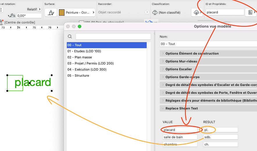

I want to create an object that show the id of the object in plan.
But if the identifier of this object is present in the MVO list, I want it to display the text chosen by the user in the model view options (an abbreviation in my case)
I am not really experienced in GDL, so I don't know how to retrive an array from an other script.

LIBRARYGLOBAL work only with 1d array

It worked well after making two 1d arrays. Thank you a lot!

Technically, returned arrays (libraryglobal, request, returned_parameters, ....) can be used as two-dimensional if declared with a fixed size in the receiving script. There are not many use cases when you know the size in advance.
