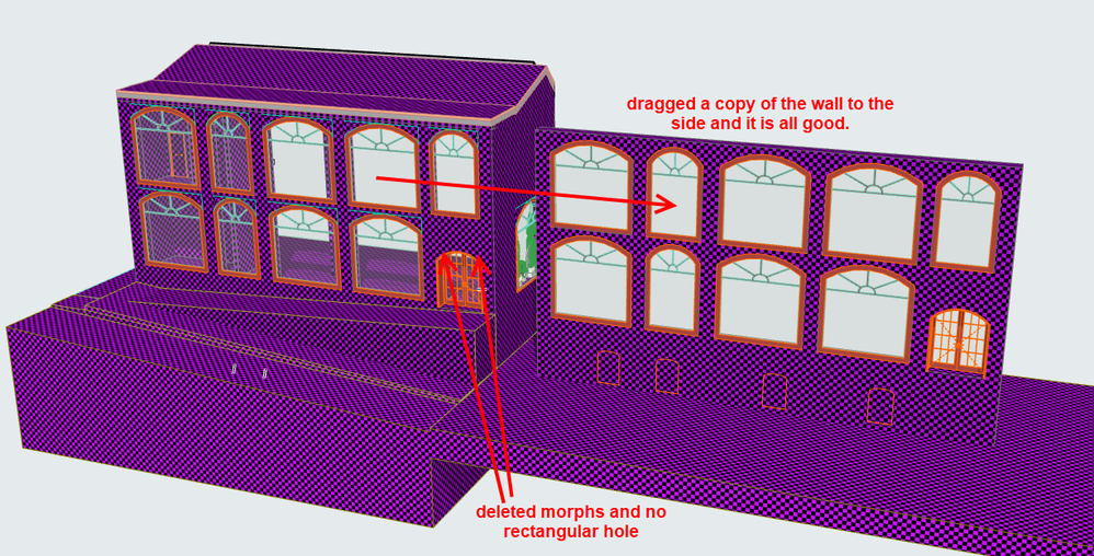

Rounded window, rectangle wall opening
Hello
I have my arched windows and doors that take an opening in the rectangle wall. I must have pressed somewhere, before that I didn't have the problem.

I see you have filled the gaps with a morph, which is a good solution to the problem.
I just don't know what the problem is.
If I delete the morphs, the window holes are arched like the windows.
If I just select the wall and drag a copy to the side, the window holes are fine.
I have no idea what is making them rectangular for you.
I am sure it has nothing to do with being an educational file.
And there is no extra elements (after I delete the morphs), just the windows and the wall.
The only thing I can think of is the machine specifications.
But I have never come across this before.

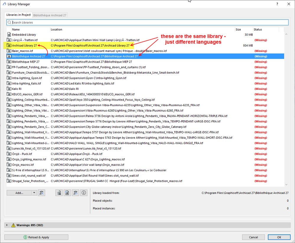

I just thought of something it may be though.
Libraries.
I don't have your language version main library, so I loaded my main library - it seems to have the same window objects which is good.
You have a lot of libraries loaded that I don't have - therefore I could not load them.
I am just wondering if there is something else in those libraries that is overriding the windows in the Archicad 27 library.
The only way to find out is to remove all except the main Archicad 27 library.
You will have many 'missing' object, but don't worry, the windows will still be there.
Now see if the window holes appear as they should.
If they do, then there is an issue with one of those libraries.
Which one I couldn't say.
If I had to guess - one of the 'macro' libraries.
If you still have rectangular holes, then that is not the issue.
Don't save the file with the deleted libraries, this is just a trouble shooting exercise.

I forgot to attach this image.
I think the Archicad 27 libraries are the same, but I am suspecting the wall hole macro is being overridden by a macro in another library.
Removing all of the other libraries will confirm or deny that.
