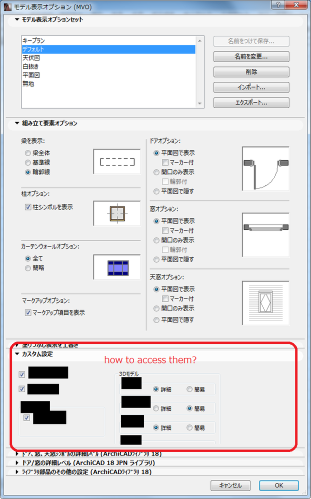

Hi!
I'm new to ArchiCAD API (about 3month).
Now I have a problem.
I learn that we can add Custom data to ModelViewOption dialog
by specially set GDL object.
I can display load it and display on the ModelViewOption dialog but
I can't find the way to access them through API.
Because my English is poor I took a screen shot.
Thank you for your help.

I haven't tried this, but it seems like you are looking for APIEnv_GetViewOptionsID. It will return API_ViewOptions. And based on its structure, what you need is API_ViewOptions->modelViewOpt->gdlOptions->params.

Thank you for your Comment.
I can do that.
I found that my custom data is added to the tail element of modelViewOpt->gdlOptions
