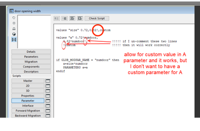

I hope I can explain this clearly.
Sample version 22 objects are attached.
I have a door object that works perfectly fine in version 22.
It has a parameter list of widths (parameter A) and a matching parameter list of door leaf sizes sizes and a parameter for the number of door.
I have used GLOB_MODPAR_NAME to say when the number of door leaf is changed, the overall width (A) should change as well - simply the number of door x the door leaf width.
I have simplified the code to what is in the attached objects (parameter script).
values "size" 0.72,0.82!,custom
values "a" 0.72*numdoor,
	0.82*numdoor!,				!!!!! if I un-comment these two lines
	!custom						!!!!! then it will work correctly
if GLOB_MODPAR_NAME = "numdoor" then
	a=size*numdoor
	PARAMETERS a=a
endif
So it is very straight forward.

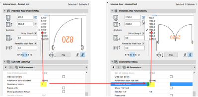

If I change the parameter for the number of doors, the value of A should change.
Which it does perfectly in version 22.
Now exactly the same objects used in version 25 - the door does not work properly.
Change the number of doors in the parameter to 2, the object settings show the correct value in the object settings, press OK, the info box briefly shows the correct value and then it changes to the firs value in the value list for A.
It should not do this.
i.e A =820, number of doors  =  1 and door leaf width (size) = 820.
Change the number of doors to 2, then A should become 1640.
Instead it becomes 1440, which is 2 times first value in size list.
Oddly if I create an object with exactly the same code, it works in both 22 and 25.
Object and door object are attached - pleas try for yourself.
If I add a 'custom' size to the parameter list for A, then is also works, but the problem is I would rather not allow a custom size for A.
I want a fixed list of sizes.
This is what I see in 22.
But in version 25+ it does not work.
Does anyone know of a reason why it does not work?
@Peter Baksa if you have time to look at this it would be appreciated.
Attached is a short video as well.
22 is on the left, 25 is on the right.
Pause at 19 seconds and you will see info box shows 1640 for width (A) then changes to 1440.

Try moving the parameters a =a out of the if statement.
And maybe set it to itself first.
If----
Endif
a=a
Parameters a=a
If I take it out of the if GLOB_MODPAR_NAME statement, it does work.
But it does need to be ...
a=size*numdoor
PARAMETERS a=a
I am not sure why taking it out of the if statement works, but I will give it a try in my real door object.
