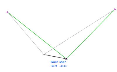

Hello,
I have created a very simple GDL object. It currently only contains a 2D script that allows the user to modify a couple of points using hotspots:
FOR i=1 TO VARDIM1(points) STEP 1
	_id = i * 6
	HOTSPOT2  points[i][1],  0, 		  i+0, points[i][2], 1 + 128 	! BASE
	HOTSPOT2  points[i][1],  0, 		  i+1, points[i][2], 3	     	! REFERENCE
	HOTSPOT2  points[i][1], points[i][2], i+2, points[i][2], 2		 	! MOVING
	HOTSPOT2  0,  			points[i][2], i+3, points[i][1], 1 + 128 	! BASE
	HOTSPOT2  0,  			points[i][2], i+4, points[i][1], 3	     	! REFERENCE
	HOTSPOT2  points[i][1], points[i][2], i+5, points[i][1], 2		 	! MOVING
	IF i < VARDIM1(points) THEN
		LINE2 points[i][1], points[i][2], points[i+1][1], points[i+1][2]
	ENDIF
NEXT i
In Action:
Then i save the object to disk File -> Libraries and Objects -> Save Selection as... -> Object
(Selecting browse instead of embedded library)
When opening the saved .gsm file again the 2D script has changed (compared to the code that I posted above):

How can i tell Archicad not to mess with the scripts (2D in this case) when the object is saved to disk?

I found the solution to instead move the GSM object from the embedded library to a folder on the disk using the Libraries and Objects dialog under "File".
Go to post
Yes, you have saved an already existing object as an object, so what you will find in that 'saved' object, it will be 'CALL'ing your original object.
Yes, you just need to go to the Library Manager and save a copy of you object from the embedded library to an external folder.
Or when you initially create the GDL and 'save' for the first time, you can choose to brows for a folder to save it in rather than the embedded library.
That folder will need to be a loaded library folder for you to be able to use the object.
Go to post

Is this 2D script replacement when saving to the embedded library reproducible?  The script you show is an auto-script typically generated by dragging 2D content into the 2D script window of the object... but definitely a bug if anything causes your own scripts to be replaced.

I think with my first approach the object was just saved "stupidly", almost like a picture of it was taken and serialized without saving any "logic". I guess you maybe want this in some cases? But i managed to solve it with in my other reply
