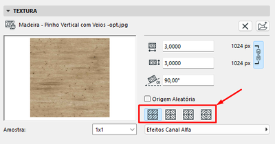

Another question, using "define texture" and "define material", is there any way to make the texture respond to the four texture distribution option buttons located in the surface settings?
runxel
Yes, but in the manual I find it not very well explained.
Basically you need to set the status in define texture "name" "filename.jpg", x, y, status, angle to one of these:
64: random
128: mirrored in X
256: mirrored in Y
384: mirrored in X/Y
