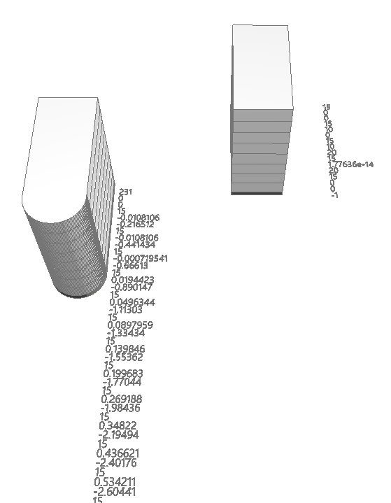

I've set up the shoelace formula and it works fine. It feels as though it would be possible to calculate even with curved edges. The slab accessory seems to convert the arcs of the slab into a prism made up of straight polylines. I haven't really figured out where in the process this happens though.
If I look at the saved parameters, an accessory created from a rectangle slab has 15 parameters (x, y & status and the first point again with -1 as status). If I make one of the slab edges into an arc, the number of parameters reach around 150-300 instead (231 in my added screenshot). So, my thinking is that I could use those coordinates for the shoelace formula in some way to get a decently accurate result, would you say that's correct?
I haven't been able to "find" those coordinates in the Properties Script, only in the 3D. Is it possible to save them in the 3D script and let the properties script read them?
I also have not been able to control the appearance of the accessory when using an arc, neither RADIUS, TOLER nor RESOL seems to affect it. Do you know if this can be done?

I looked into it and the add-on gives only straight edges to the slab object. It can't be controlled.
The polygon is a parameter, it should be available in the properties script. There is an example in the "Footing 1" object.

Thank you Peter!
I looked into the Footing object and could figure out what to use in my object. It's not the most elegant, but it does the job.

Sorry, labels can't show properties from the properties script, those are only available for Lists (not Interactive Schedules). But you can access parameters from a label (use REQUEST "assoclp_parvalue") and do the calculations in the label.
Setbacks like solid operations? That sounds difficult, you'd have to intrepret the shape somehow to know what to do.

2021-11-12 04:21 PM - edited 2021-11-12 04:24 PM
num_stories = 0 ! this will receive the value if found
n = REQUEST ("ASSOCLP_PARVALUE", "num_stories", _unused, type, flags, dim1, dim2, num_stories)
type, flags, dim1, dim2 are returned from the labeled object, you can double-check them to see whether it's the same parameter that you expect.
There is no polygon input method in GDL. You could draw a set of editable hotspots on the polygon to define a second polygon that can be edited vertex by vertex, and you might need some button on the UI to reset it to the current contour of the object.

2021-11-22 11:49 AM - edited 2021-11-22 11:49 AM
The request always returns a one-dimensional array:
p_values:  for ASSOCLP_PARVALUE returns the parameter value or array of values. The array elements are returned successively, row by row as a one dimensional array, independently of the dimensions of the variable specified to store it. If the variable is not a dynamic array, there are as many elements stored as there is room for (for a simple variable only one, the first element). If values is a two dimensional dynamic array, all elements are stored in the first row.You need to convert the one-dimensional array to two-dimensional (or use it as such, calculating indices).
