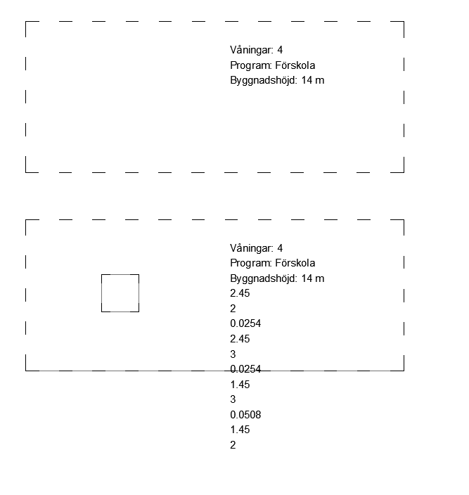

So, I managed to almost figure it out, but there are still some issues. I used the ASSOCLP_PARVALUE to request ac_coords, which in my object are the coordinates of the slab. However, when imported to the label, I only get the coordinates of holes in the slab - see attached screenshot 1. This the code I use:
DIM ac_coords[]
n = REQUEST ("ASSOCLP_PARVALUE", "ac_coords", _unused, type, flags, dim1, dim2, ac_coords)
FOR i=1 TO vardim1(ac_coords)
TEXT2 x,y, ac_coords[i]
y=y-radhojd !Moving text to next row
NEXT i
The coordinates imported also look a bit weird. The 0.0508 (which is the status code meaning end of polygon) comes one coordinate to soon, and the last coordinates do not have a status code at all.
Any idea where the problem might be?
