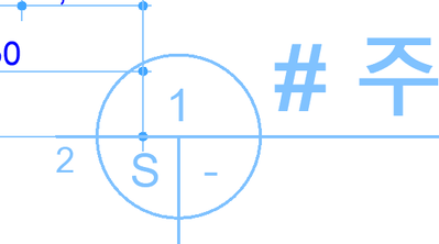

if "<Dong Name>" = "" then
     text2 0,0,1
else
     text2 0,0,2
endif
Number 2 appears. Even if you use "#", you get the same result.
How do I know if the space is blank?
The title indicates that the variable value is blank.

As far as I know, GDL can not read the value of the Project Info variables
That is probably why you can't determine if it is empty or not.
All GDL can do is display the value.
It will be blank if it is empty.
Yes, you have to turn it on/off as an option.
