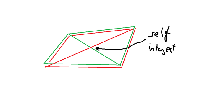

My guess is:
Because its very thin and depending on how top and bottom faces are triangulated
-> some self intersection could happen.
And when you apply the cut it probably tries to "fix" it.
Solution would be to make the Tube more detailed, more controlpoints in the recetangle aswall as in the path curve
-rudl

More detailed...meaning more vertices...does not help much - the triangulation algorithm is not aligned unfortunately.
What i noticed - the top surfaces of say. both tubes are aligned, but the top and bottom surface never. It seems the initial designer of this command did not take care about it 😞
So finally I will do the bolean ops 😞

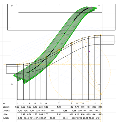

in my recent codet Stair-Tool, using the Goodies-addon for Polylines, i did not use the tube-command - of that reason - but instead i used some SEO-operations to get similar forms - rough so far, but geometrically ok. (german, but i thin you get the point.. The script - Made by Google-KI Gemeni3Pro (and me)..

a ramp with mass-command - not directly with tube. Tubes just for the ramp edges - made 95% with Google-Gemini3Pro AI and my corrections in a few hours. You just have to make very little steps (prompts) and have patience, let it correct the errors from Archicad's test routines - simply copy the error messages to the prompts - it mostly corrects it, if not, try again. Sometimes it "halluzinates" commands from other Script-languages, but Archicad's test-routine will point at it, so You can send a correction-promt to the AI.
(german)
https://www.youtube.com/watch?v=3kemRVxB1PA
AC29EduAut-Version: https://www.dropbox.com/scl/fi/kepw3jkgl9uiketrpj2hi/Strassen-T-8-und-Rampe-29a.pln?rlkey=r5b5hqamqv...
