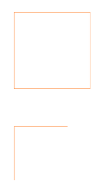

Hello everybody,
I'm about to capitulate on an issue I've been banging my head against. The projected parts of an "isected" body isn't drawn completely using the project2{4} command. Would be greatful for any thoughts.
All the best,
Péter

Paalanen
Thank you Sir Pääsky!
The project2{4} command produces a section through the 3d body if the cutheight is set to cut it. In addition, it produces a projection of whatever is in front of the cutheight and not cut. The polygons of the cut and the projection are controlled separately. In my example, cutheights 0,3-1 produce sections. 1 and above will produce a projection. The section works fine. However, the projection is faulty and this happens specifically when "isecting" groups. See attached pic below - I added a simple block to point out that the projection does work when not "isect".
Watch your forehead : )
Paalanen
Turns out that the "missing" lines from the projected isect groups are controlled by the "cutLinePen" and "cutLineType" of the 1st half of the command. This muddles up section and projection in a most unwanted way - must be seen as a bug. At least it makes the otherwise brilliant command useless to what I need to achieve.

Paalanen
Thank you! However, the model I would have liked to project would have been one with intersected groups. Now an alternative solution for the intersection needs to be found...
