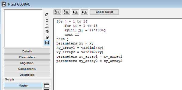

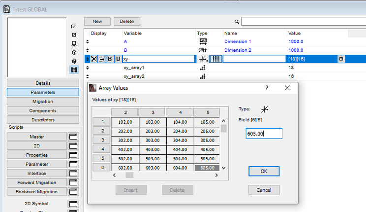

I set the array sizes in the global
!!------this bit is just to set some values for this test
for j = 1 to 16
  for ii = 1 to 18
    xy[ii][j] = ii*100+j
  next ii
next j
parameters xy = xy
!!------this bit measures the size of the array and sets it as variables that can be read
xy_array1 = vardim1(xy)
xy_array2 = vardim2(xy)
parameters xy_array1 = xy_array1
parameters xy_array2 = xy_array2

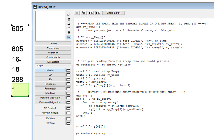

then read the array,
you will see that the new array read will only be a 1 dimensional array
so a 1x288 rather than a 18x16 as per the original
!!!----READ THE ARRAY FROM THE LIBRARY GLOBAL INTO A NEW ARRAY "xy_Temp[][]"----!!
dim xy_Temp[][]
!!!___note you can just do a 1 dimensional array at this point
!!!"dim xy_Temp[]"
success0 = LIBRARYGLOBAL ("1-test GLOBAL", "xy", xy_Temp)
success1 = LIBRARYGLOBAL ("1-test GLOBAL", "xy_array1", xy_array1)
success2 = LIBRARYGLOBAL ("1-test GLOBAL", "xy_array2", xy_array2)
!!!!if just reading from the array then you could just use
co_ordinate1 = (xy_array2)*(6-1)+5
text2 0,1, vardim1(xy_Temp)
text2 0,2, vardim2(xy_Temp)
text2 0,3,xy_array1
text2 0,4,xy_array2
text2 0,5,xy_Temp[1][co_ordinate1]
!!!----CONVERT 1 DIMENSIONAL ARRAY BACK TO 2 DIMENSIONAL ARRAY----!!
dim xy[][]
for j = 1 to xy_array1
for i = 1 to xy_array2
co_ordinate = (j-1)*xy_array2+i
xy[j][i] = xy_Temp[1][co_ordinate]
next i
next j
text2 0,7,xy[6][5]
parameters xy = xy
I hope this helps
