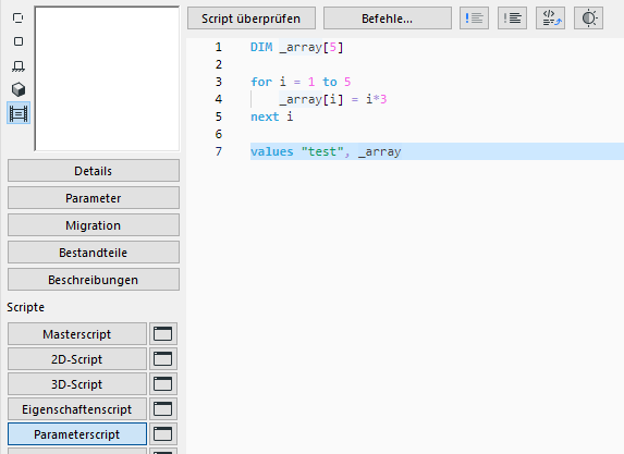

Hi
it is possible. Here a quick preview:

vlahtinen
What's the type of the parameter? If it's numerical, you could use parameter buffer (put and get). If it's a string, you'll have to use values{2} and create a parameter for the numerical representation of the value, which is a good idea anyways.
Edit: never mind, see @Xandros' solution below.
