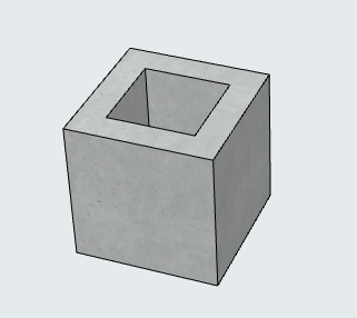

I want to make a Block in GDL with an internal hole, the object made in the simplest possible way. Of course I can make four walls and a roof and make a Block with a hole that way, but I want to make two Blocks, one regular and one smaller void-Block. Is there a command for void in GDL?

It can also be done with a BLOCK and a CUTPOLYA.
The depth of the CUTPOLYA can be limited so it is not infinite.
Just a matter of positioning it and rotating if necessary.
A little harder to work with as you can't see it unless it is cutting something.

Pointing me in that direction, I managed to create a Block with a hole 😊 But I do not know how to make the hole finite, so that there will be a "roof" in the Block. I tried with this script:
Material 4
a=1.0
d=0.2
GOSUB "rect_cut"
DEL 1
BLOCK a, a, a
CUTEND
END
"rect_cut":
    CUTPOLY 4,
            d, d,
            a-d, d,
            a-d, a-d,
            d, a-d
    RETURN
Any suggestions?

CUTPOLYA is a half infinite tube from the x-y plane, and you can set the length of that tube (0 is infinite length).
You can also mask the edges of the cut as you would mask the edges of a PRISM.
