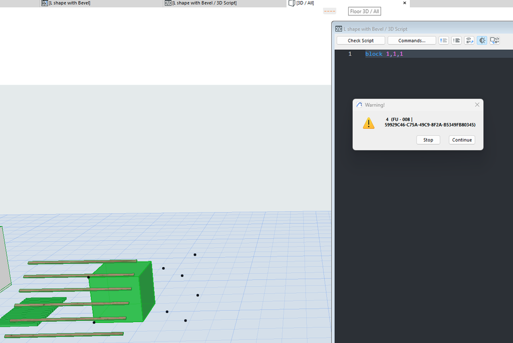

I have gotten a really weird warning message. It happens when I save my gdl object and go straight to the 3D view (not the object 3d view,
Saving the object is not a problem, the warning pops when I click on the 3d viewport.
I try to do a google search with no luck.
2 REPLIES 2
Are you sure it is that object causing the warning?
It is certainly not from the 3D script.
But it could be in the Master script.
Look for an element with an ID of FU - 008.
That is causing the message.
Thank you for the reply, I found the object with that ID, delete it and now is ok.
Funny tho is that I had that object yesterday and no warnings at all, it did happen all of the sudden when I saved another object I was working on.
