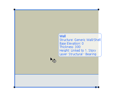

The left window is one gsm.
And the window on the right is the window that called the same file in master script.
if GLOB_SCRIPT_TYPE <> 7 & GLOB_SCRIPT_TYPE <> 8 then
call "test-01" parameters all
endif
Why is there more Hotspot2 on the right side? (I want to get rid of it)
And wallline2 and so on do not appear.
I want to study why this happens.
Which part should I study to understand it?
It was tested again.
I want to make 8 points into 4 points
I found that. ^^
AC27 on window 11

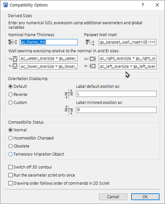

1 REPLY 1
Peter Baksa
Probably it is caused by ac_hole_hotspot_control
About wallline you can read here and here
I hope it helps.
