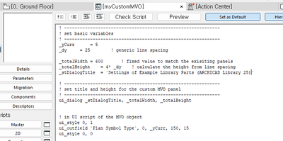

Why does MVO step 2 not work?
Custom-made Model View Options object | GRAPHISOFT GDL Center
I copied and pasted it, but no matter what I do, the name doesn't change.

This part needs to be included for it to work.
! in UI script of the MVO object
ui_style 0, 1
ui_outfield `Plan Symbol Type`, 0, _yCurr, 150, 15
ui_style 0, 0

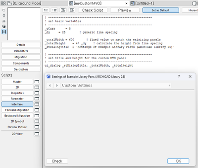

AC27 on window 11
I don't know why.
It is the UI_DIALOG line that creates the title.
If you now comment out those extra lines, does it stay showing 25?

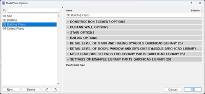

I think it was just not updating for some reason.

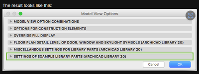

Notice in your first image 3 titles were saying "Library 20".
Which makes me think the wrong library was loaded.
And now you have a completely different list of titles showing 25.
LeeJaeYoung
The image above is an image of the linked Custom-made Model View Options object. ^^
25 is the image I followed.
However, everything is handled behind the scenes.
If you succeed and delete that part again, the same phenomenon occurs.
I'm going to be satisfied with this.
