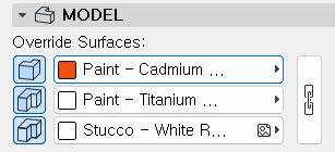

How can I get an override material for the wall?
I'm trying to get the override material for the wall from window & door.

You need WALL_MAT_A, WALL_MAT_B, WALL_MAT_EDGE
But I think the values returned depend on how the window/door is placed in the wall - opening toward reveal side or not.
Lingwisyer
Guru
Following from Barry's, you can determine which side of the wall the door / window reveal was set to then flip WALL_MAT_A and WALL_MAT_B as required.

I would like to know how to know when this button has been pressed.
I'm asking this question because I think I need to know whether this button was pressed when comparing wall_mat_a with wall_skin_param.

This is not the same as the button for flipping in the windows and doors.
That I think is WIDO_REVEAL_SIDE.

	IF WIDO_REVEAL_SIDE = 0 then
			WALL_MAT = WALL_MAT_A
		else
			WALL_MAT = WALL_MAT_B
	endIF

I would like to know the function that determines whether this button has been pressed.
Even though I read it, I can't find that part.
Does this have anything to do with it?
WALL_SKINS_PARAMS
[19] skin edge surface index (considering wall edge surface override). Compatibility: introduced in ARCHICAD 22.
