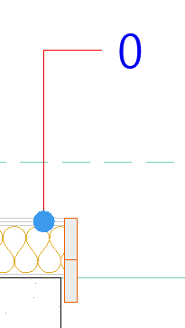

Unable to obtain insulation thickness for WALL_INSU_THICKNESS.
LeeJaeYoung
It was just made in Korean.
Do I have to use the Korean name only in the Korean version?

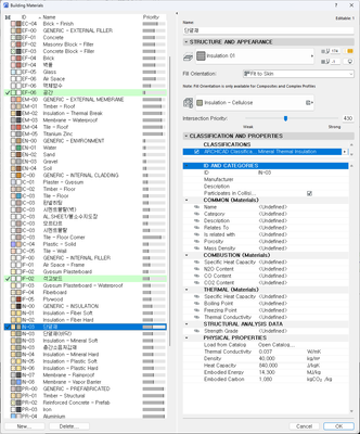

How do you use the Global „WALL_INSU_THICKNESS“ in your script?
Jochen Suehlo . AC12-28 . MAC OSX 14.4 . WIN11
LeeJaeYoung

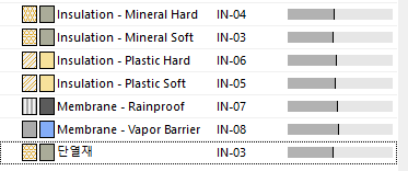

I'm trying to get that value.
However, in the int version, the value in English appears.
However, the ingredient names in Korean do not appear.
_stringValue1 = STR(WALL_INSU_THICKNESS*1000,4,0)
korea name "단열재"
english name "Insulation - Mineral Soft"
AC27 on window 11
When I use your value „단열재“ for the name of the Building Material of the insulation,
I get a correct thickness value in the label as well. I tested it in AC 27 (German Version) on macOS.

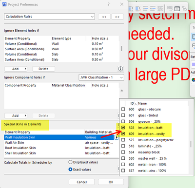

Have you set what building materials are to be used as insulation in the calculation rules?
Does this make a difference?
