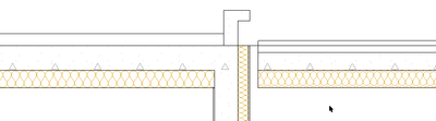

Why is the GDL slab not expressed as a fit for insulation? Is it possible?
This is a cross section.
The left insulation mark is a slab.
The insulation on the right is a slab in the GDL.
Is it possible?
AC27 on window 11

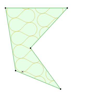

Fit to skin doesn't work in GDL.
There is a note under Building Material's Fill orientation, that it is only available for Composites and Complex profiles. GDL doesn't have such commands, even saving a composite as GDL Object explodes the skins.
Logically a privileged direction is needed perpendicular to which the fit is done. This direction is defined by one side of the composite or profile. A general GDL potato doesn't have such direction. For example this profile section
defines the fit basis along the left side, and the width is averaged from the other vertices.

I assume you are talking about the "Fit to Skin" option for Building Materials, and you are saying that when you model a Slab in GDL, the insulation Material's size does not adjust to the thickness of the Slab.
Actually, I am not sure this capability is available for geometries generated in GDL. Perhaps someone more familiar with this than me can chime in.

Yeah!
What I am talking about is when creating walls, slabs, etc. in GDL.
The fit to skin inside the soft insulation does not work.
It is the same even if the material index is obtained from WALL_SKINS_PARAMS.
I'd like to know if it's a Graphisoft bug.
Do they answer here?
Thanks for reading.
