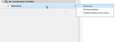

LeeJaeYoung
You need to clear this part. Is it because of the marker interface?

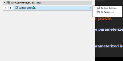

LeeJaeYoung
1. My mistake was not creating the gs_ui_current_page (integer) parameter.
2. in parameter Script
If "hideparameter all" is not executed, the following state is always maintained. You must run it to go to the page you were editing.
3. Pages are not visible unless Hierarchical pages is turned on.
TABID_ROOT = -1
_idxTab = 1
TABID_DIMENSIONS = _idxTab : _idxTab = _idxTab + 1
TABID_2DREPRESENTATION = _idxTab : _idxTab = _idxTab + 1
TABID_3DREPRESENTATION = _idxTab : _idxTab = _idxTab + 1
! set the title of the UI area popup
ui_dialog `My custom object settings`
! set the parameter "gs_ui_current_page" for actual page display
ui_current_page gs_ui_current_page
! Display actual tabpages using extended ui_page command
ui_page TABID_DIMENSIONS, TABID_ROOT, `Dimensions`
gosub "pageDimensions"
ui_page TABID_2DREPRESENTATION, TABID_ROOT, `2D Representation`
gosub "page2D"
ui_page TABID_3DREPRESENTATION, TABID_ROOT, `3D Representation and Surfaces`
gosub "page3D"
