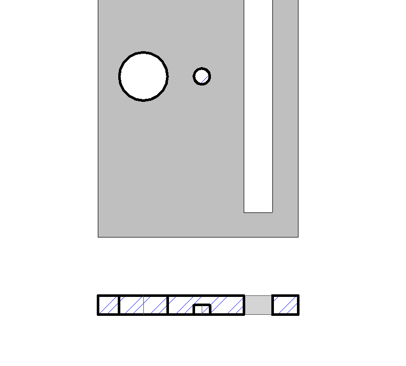

Paalanen
Hello Péter,
Been working with the project2{4} command quite successfully until now. Holes using cutform punched into my projected prism are projected as cut shapes instead of projections. Tried and failed fiddling with the status and mask codes.
Attaching a screenshot of a prism projected from the front - The circles are "cutforms", the left one is an infinite cut (status 1+8+16) and the right semi-infinite (status 1+16). The correctly projected rectangular opening is defined in the prism itself.
Would be super greatful for some guidance once again.
Peter Baksa
What is your code for this?
