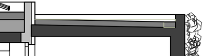

When we list aims to a road map...today, I add just one ting... and this is...
...that in sections and elevation uncut lines in the background doesn't cover any more cut lines of the foreground... too often the case... like her again, and again

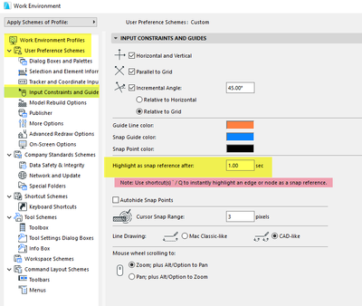

Right now, I just wait one second till the blue location circle (snap guide) decides to show up and then make my moves. I must find out how to get the blue circle to show up faster in the settings dialogue lol.
I'd vote no for the dimensions adjusting the elements, but then I have never used a program that has it.
Just my opinion.
The snap delay is in your Work Environment.
But if you set it to too small a time delay, you might get frustrated the snap references keep appearing all of the time.
Or you can leave a short delay and then just use the keyboard shortcut to activate instantly - best of both worlds.
What would be a more acceptable delay time, 0.5 of a second ?
Excellent tips BTW.
