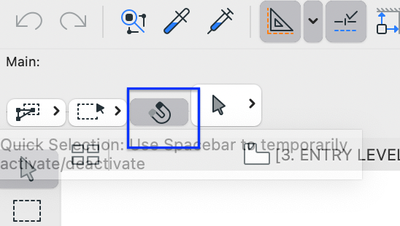

I am having problems picking items. Used to be easy, pick anywhere on an item to select it. Now I can't. Have to pick on a point around the item. They've done something. Had to take time off to have my leg removed. Now they changed it. Don't know if they changed something or there's a button that needs to be pushed to get it to work right.

Kevin Lee
quick selection turned off?

mukster
No, it's on

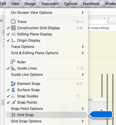

Eduardo Rolon
Check that "Grid Snap" is turned off.
