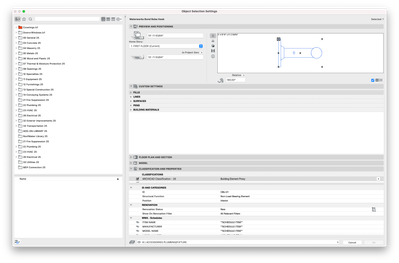

is there a new feature I am missing which excludes the organizing folders in the object tool list? I should see "Archicad ibrary 25" and "Office Library 25" and "embeded Library" and a few others... but all i get is a random list of folders that make absolutely no sense!

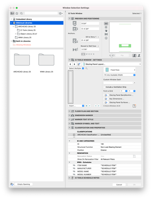

other library based tools look fine, windows and doors for example show the primary library folder.
left column does not have library containers:
windows and doors doo have library containers:
