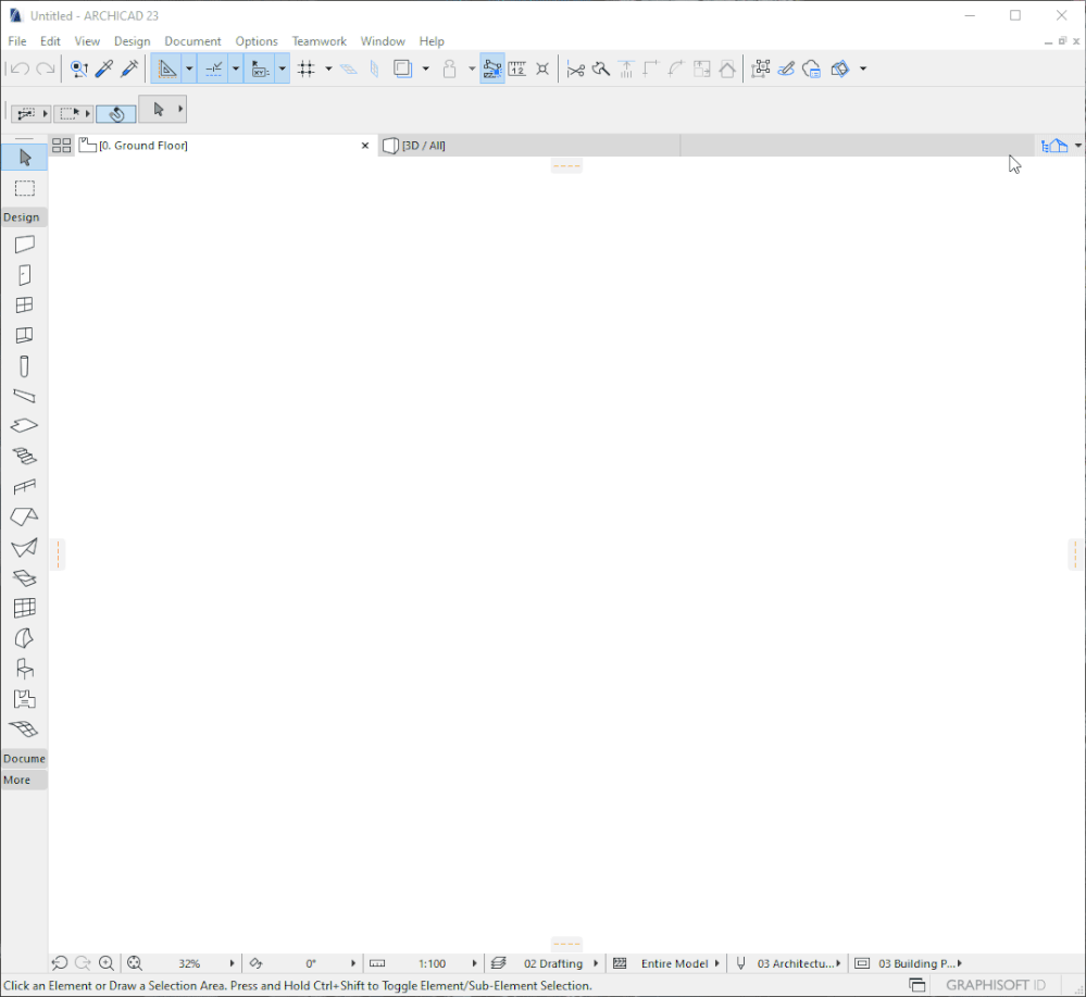

Where to find the Navigator?
The Navigator Palette is not shown by default to dedicate the largest area to modeling and design. You can show/hide the Navigator using one of the following options:
  • Window > Palettes > Navigator
  • Context menu commands (available after a right-click) from the Project Chooser or header area of the Pop-up Navigator, or the Navigator Palette itself
The Navigator can be pinned/docked to the side of the work environment by dragging the palette close to the window's edge.

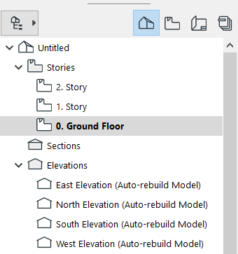

The Project Map of the Navigator provides a tree structure of the viewpoints of your Virtual Building Model.
What is a viewpoint?

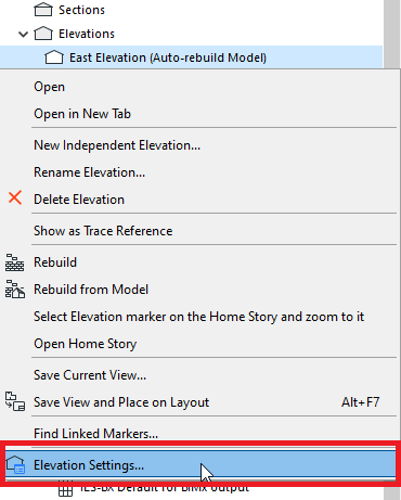

The viewpoints (sometimes also called model views) define the position and the direction from where you are looking at the model and also the type of projection. It can be a 3D view (perspective or axonometric) of the model or a 2D view, like floor plans, sections, elevations, details, etc.
You can navigate between the different viewpoints simply by double-clicking on their names listed in Navigator. An open viewpoint will have the name in bold characters. If you click only once on another viewpoint, you select that viewpoint, but you won't be navigated to it, however you can access its settings and many other options of the selected item with a right-click.
If you create a new section, elevation, or story, it appears automatically under the Project Map.

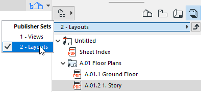

Depending on the default template, Archicad will create some Publisher Sets by default in PDF format. Publisher Sets can be selected by clicking on the list at the top of the Navigator.
PDF (Portable Document Format)
PDF (Portable Document Format), is a format typically designed and used to distribute read-only documents that preserve the layout of a page. With PDF, you can ensure that the arrangement and formatting of the exported Layouts will be preserved for later production (distributing, printing, etc.)
The wp-content_uploads_2019_10_Show-Publisher-Set.png button at the top of the Navigator will provide an overview of all Publisher Sets you have in the project.

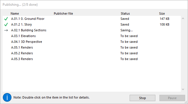

  7. Click Publish at the bottom to start the publishing process.
  8. The Publishing dialog will open, showing the progress of the publishing process. You can Stop or Pause the process using the button on the dialog.
  9. The dialog can be closed when the Close button appears.
