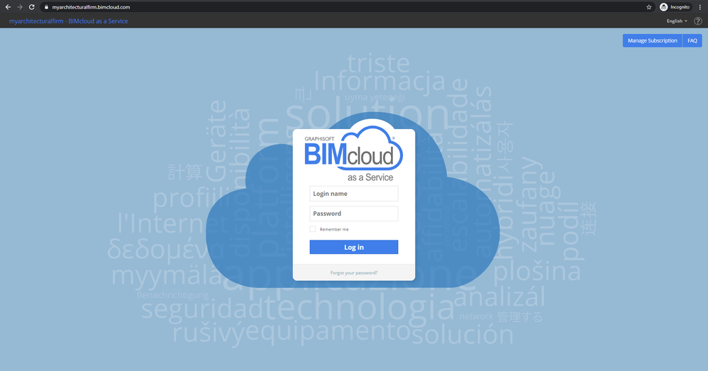

Step 2 - Login to your BIMcloud as an administrator
Once you successfully registered in our system, your new BIMcloud will be accessible in the browser from a link like https://myarchitecturalfirm.bimcloud.com where myarchitecturalfirm should be replaced with the name you chose during the registration process.

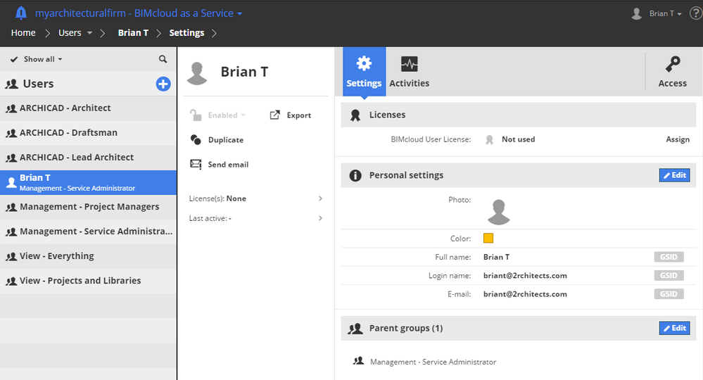

Step 3 - Add users
You need to setup users for your BIMcloud. You can either create new users or import existing ones from your previous BIMcloud.
Creating new users
To be able to work with other colleagues, you will need to create an account for each of them. On the Users page you can create your new users with entering:
  • Name of the User (will be presented in Archicad)
  • Username (to be able to log in to BIMcloud Software as a Service)
  • Password
  • E-mail address (to be able to change previous password anytime)
All users should be added to all of the following groups:
  • ARCHICAD - Lead Architect
  • Management - Project Managers
  • View - Projects and Libraries
With the above settings, all of your users can access all projects and can work with no restrictions in Archicad.

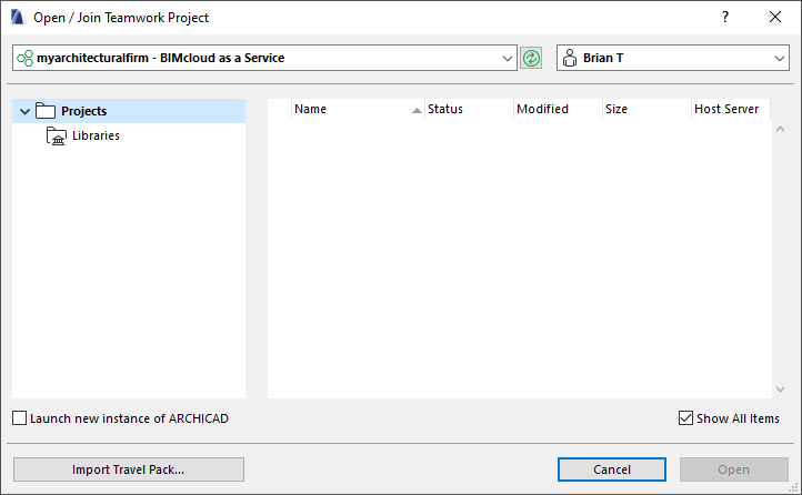

First things first, you need to connect to BIMcloud from Archicad. Start your preferred Archicad version (Archicad 20 build 6000 or newer, Archicad 21, 22, 23, 24 and 25 with any updates) and log in to your new BIMcloud from Teamwork > Project > Open / Join Teamwork Project...
Do not forget to put https at the beginning of the address to be able to connect to your BIMcloud Software as a Service. Once you are successfully logged in, you will see the Project tree on the left side and content of selected folders on the right side.
Upload a new project
Now that you are connected to your BIMcloud, you can upload your projects from Archicad. The process of creating a new Teamwork Project is called “Share.” You open an empty or an existing solo Archicad Project file (.pln) in Archicad, then go to Teamwork > Project > Share...

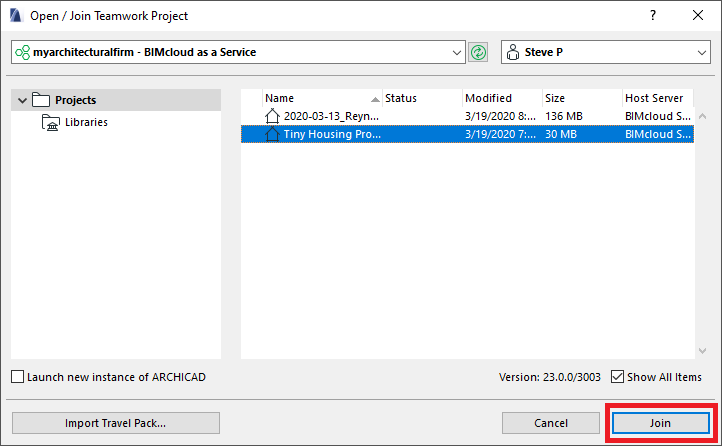

Opening a project
If you were the user who shared the Teamwork project, you are automatically joined to this project. If you want to join a project shared by someone else go to Teamwork > Project > Open / Join Teamwork Project..

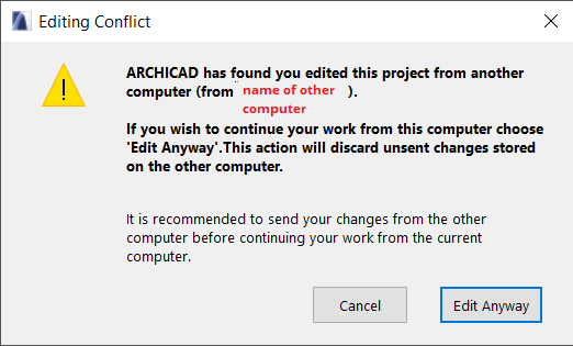

Please note that the same user cannot be logged in in the same project on different computers at the same time.

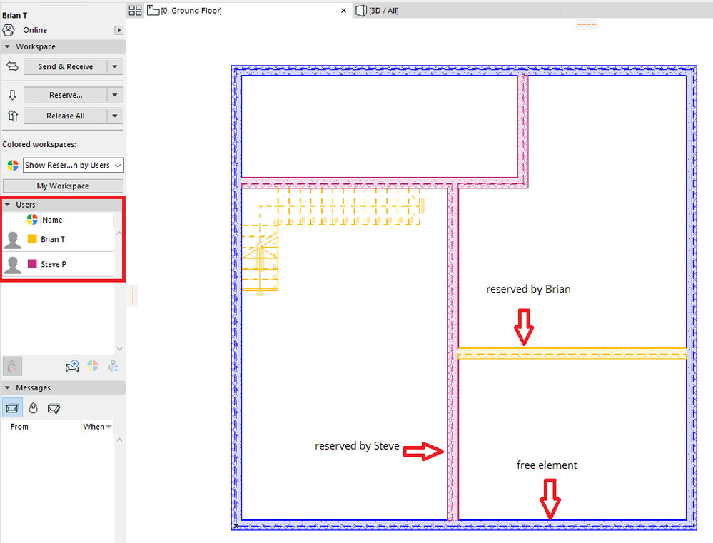

Creating elements
Once you joined a project you can create new elements.
Existing elements are either free or reserved by someone. You can reserve free elements - see next chapter - but you cannot edit elements owned by others.
Owning certain elements and project data ensures data safety - your project will stay consistent and controlled by team members. Any new element or project data created by you will be automatically owned by you.
Elements and project data reserved by other users can be requested for modifications. Currently reserved items can be also released by users at any time. Free elements can be reserved by any of the users.
For more information, please check out:
Reserve and modify existing elements
Any elements and project data which have no assigned owner can be reserved by joined users. Reserving in a Teamwork project means you assign a certain element to yourself. Once you reserve an element, you can freely modify or delete it.
