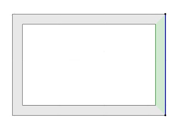

Once more, you first must select the element.

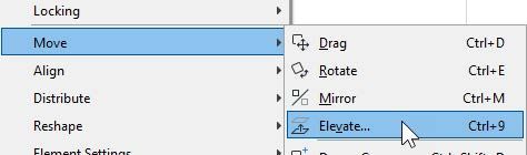

Then, invoke the “Elevate” command via Edit > Move or from the pet palette.
This brings up the Elevate dialog box, where you can enter the value by which you wish to raise or lower all selected elements.
  • Enter a positive value to raise and a negative value to lower the element along the Zaxis.
  • Confirm the input with “OK”.

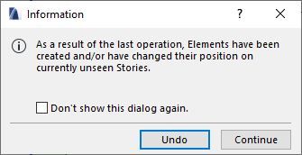

  • A warning message might appear if the wall is elevated to a hight above the cutting plane.
  • The warning asking you to confirm the change because the result will make the element not visible on the current view.
  • Press continue.
The chosen wall is now raised to 1,20 meters, which is above the Floor Plan Cut Plane. Therefore, the wall in the ground floor is not visible but appears in the 1st floor plan. The result is also visible in the 3D Tab.
