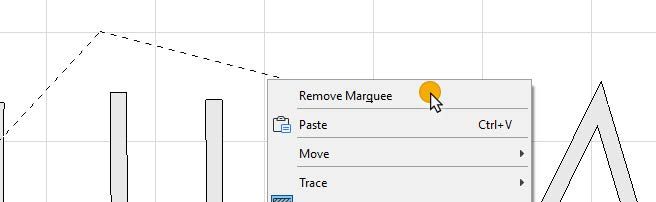

To delete the Marquee
  • double-click anywhere outside of it or
  • right-click and select the Remove Marquee command in the context menu or
  • hit Esc

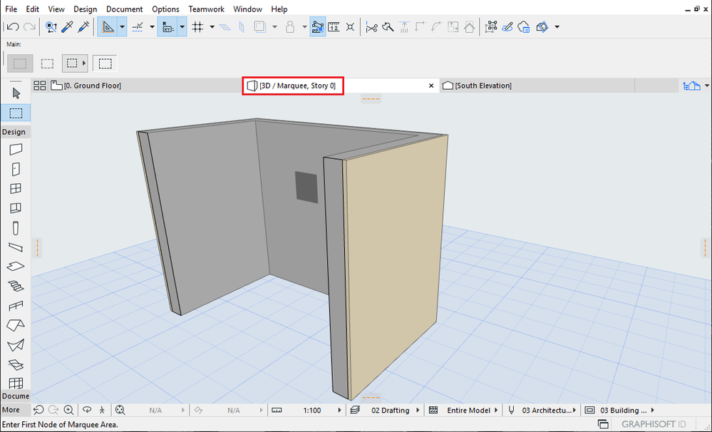

The area within the marquee, that you placed on the floor plan, will be shown in the 3D window.

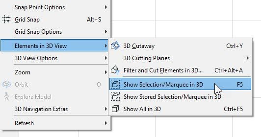

To see only the marked area in 3D, go to View > Elements in 3D View > Show selection/marquee in 3D. This command takes you to the 3D window.
The 3D window tab also tells you that you are currently only looking at a fraction of your plan, defined by the shape of the marquee.

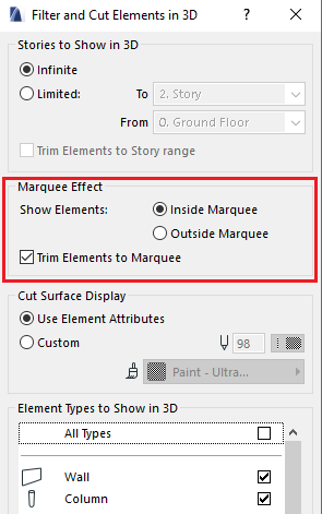

Go to View > Elements in 3D view > Filter and Cut Elements in 3D to access further options related to the marquee:
  • you can revert what area to show: inside or outside the marquee
  • you can decide if the elements should be cut by the marquee
