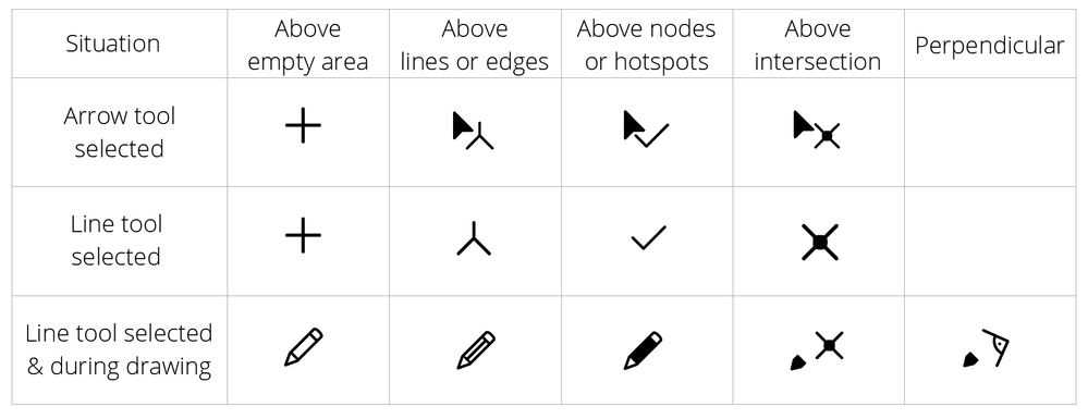

The cursor changes its shape(s) as you work giving you accurate feedback on:
  • where the cursor is and
  • whether an editing or input operation is going on or not.
The shape of the cursor sometimes also depends on which tool (Arrow Tool, Marquee Tool, Wall Tool, Door Tool, Line Tool, etc.) you are working with and at which step of the input/editing operation, you are at. The most basic shapes of the cursor are the following in the table below:

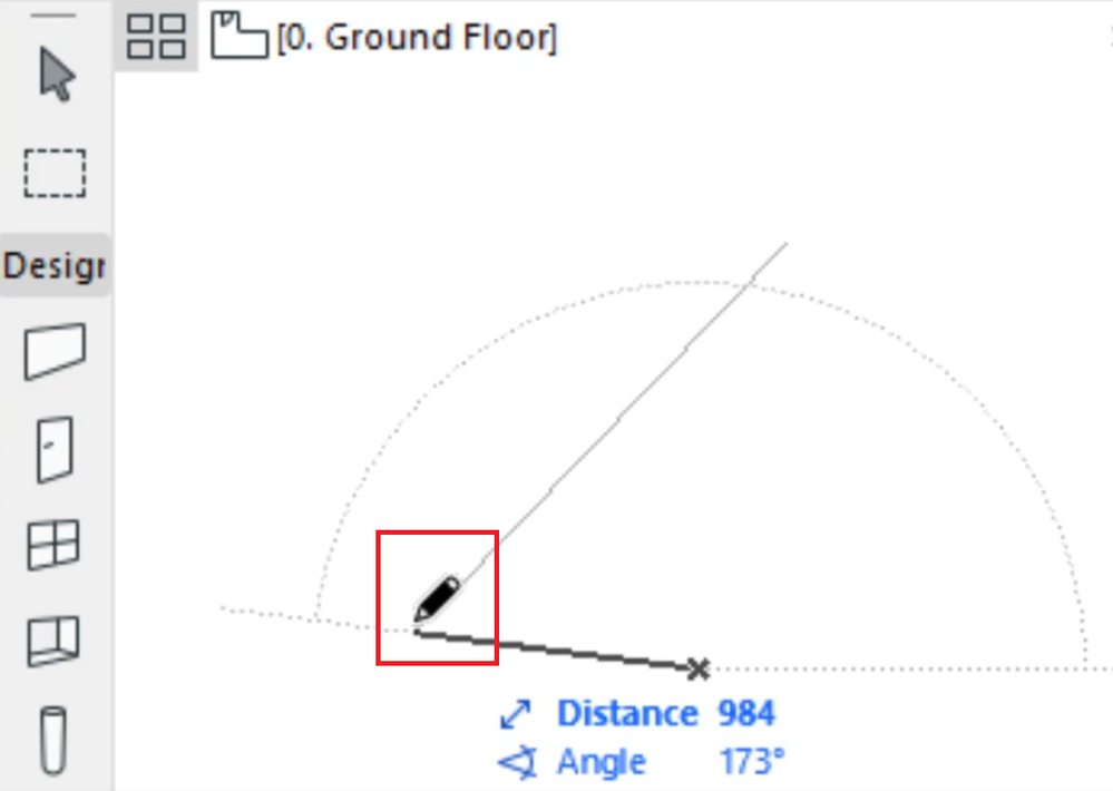

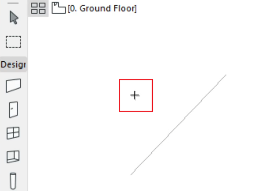

Let's see an example. Let's see how the cursor works when you draw a line.

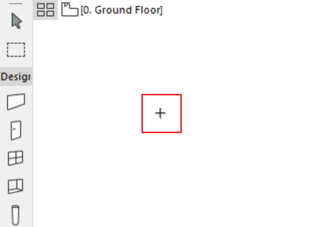

Before you start drawing the line, the cursor's shape is a crosshair.

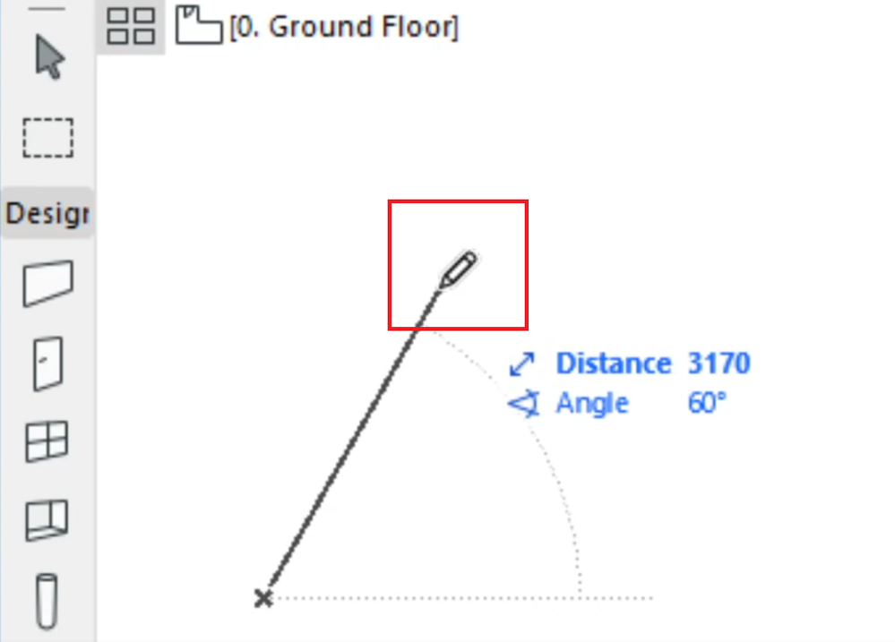

Click and start drawing the line. Then move the cursor. During the line creation, the cursor changes to a white, empty pencil.
After completing the line the cursor changes back to its crosshair shape.

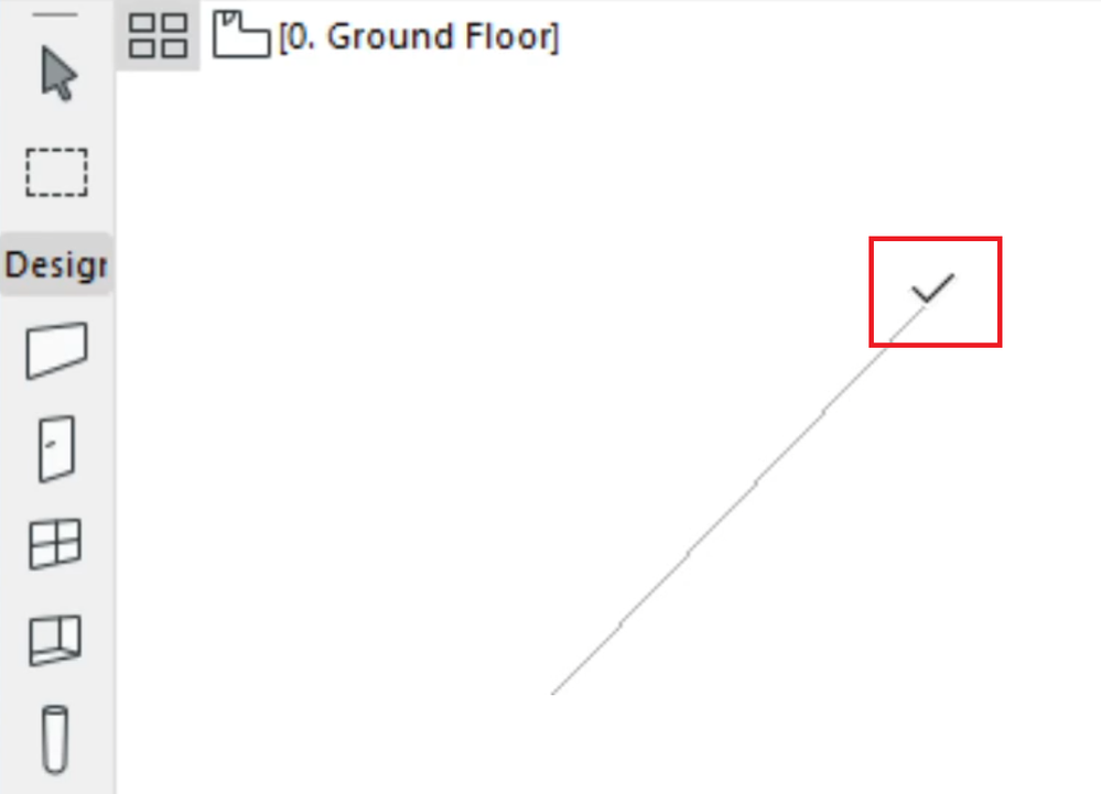

If you move the cursor now to the end of the line, its shape changes to a checkmark.

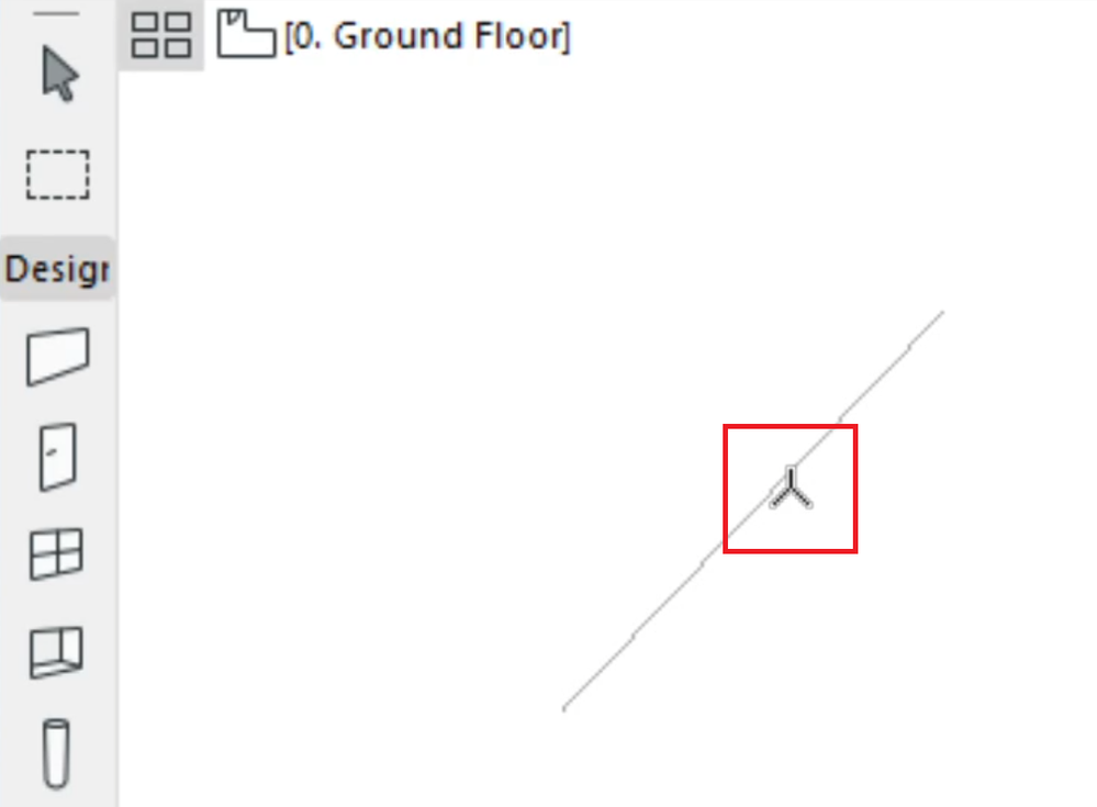

If the cursor is anywhere else along the line you will see a “Mercedes star” shaped cursor.
Let's draw another line. Start it at the empty space one more time.

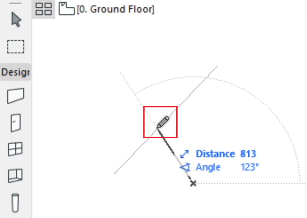

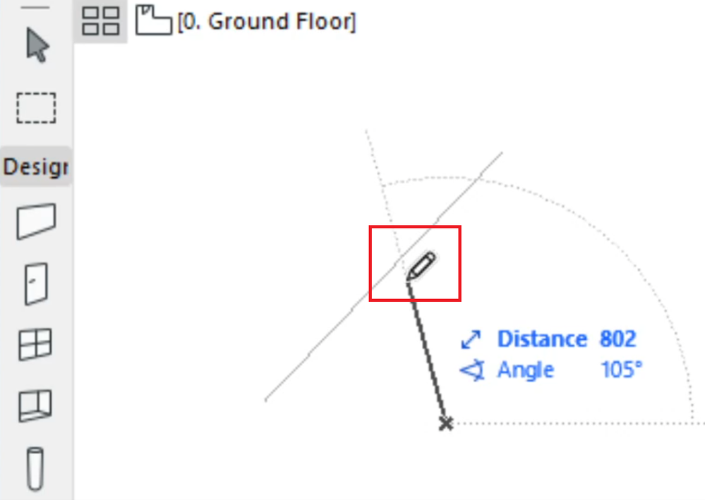

If you now move the cursor onto an existing line, the shape changes again. This time, the white pencil contains a black line.
If the cursor is at an endpoint, the pencil turns black.
