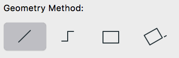

When using the Line Tool, you can select between four different Geometry Methods:
  • Single
  • Chained
  • Rectangular
  • Rotated Rectangular

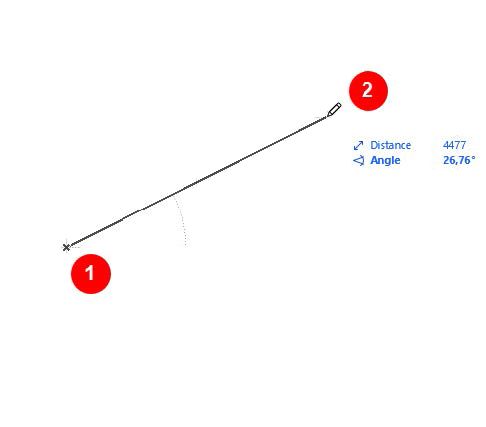

Single

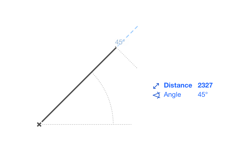

A single line is defined by two points. Start the line by clicking anywhere in the empty workspace. Now move the cursor and click again to complete the line. Until completion with the second click, the line is "elastic", stretching between the start point and the current position of the cursor.

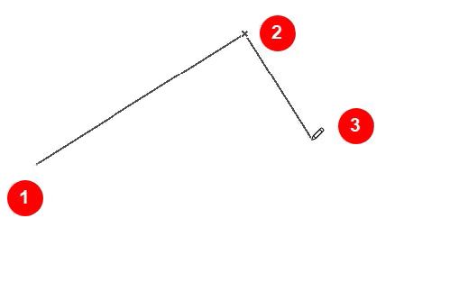

Chained
This Geometry Method creates a chain of lines. The start point is indicated by the first click. The second click is the endpoint of the first segment as well as the start point of the second one. This could be continued almost endlessly. To finish the chain of lines click on the end point of the last segment once more.

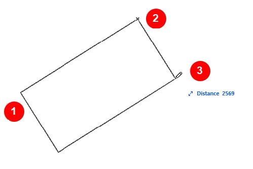

Rotated Rectangular
This method defines a rotated rectangle consisting of four separate lines. The first click indicates the start point. The second one indicates the first side length and the angle of rotation at the same time. The third click completes the rectangle by defining the second side length.

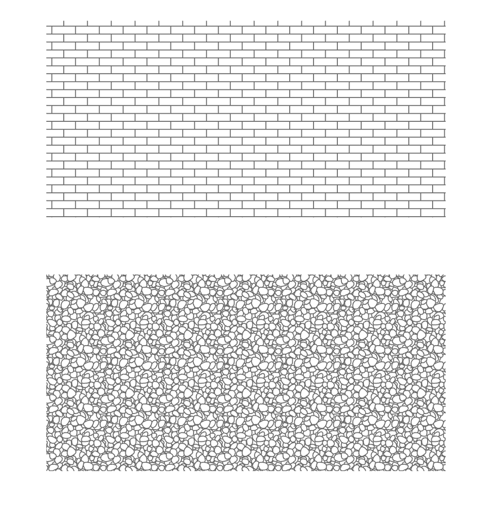

The Fill Tool
You can find the Fill Tool in the Document folder of Toolbox. You have to open this folder by clicking on the dark gray area first if the folder is closed.
The Info Box now shows the default settings of the Fill Tool:
When using the Fill Tool, you can select between three different Geometry Methods:
  • Polygonal
  • Rectangular

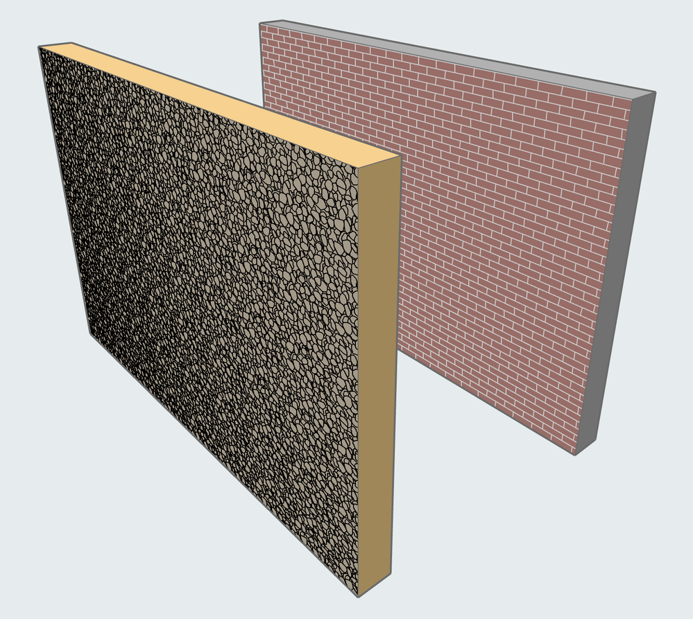

Lines, arcs, and fills can be independent elements you can place in all sorts of viewpoints and views, except in 3D. They are also used in the 2D and 3D representations of more complex Archicad elements, such as walls, slabs, etc.
