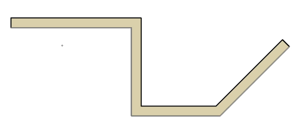

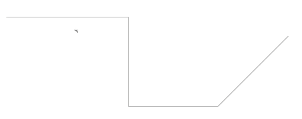

You have already drawn a few lines and now want to trace them with the Wall Tool.
  • Use the Magic Wand to simplify the process.
  • First, select the Wall Tool.
  • Now, invoke the command either at the menu point Design or by holding down the SPACE-key.
  • The cursor turns into the Magic Wand.
  • If you hover the cursor over the line, you can see a preview of the walls that will be created…
  • To complete the command, click on the line.
