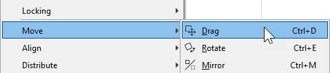

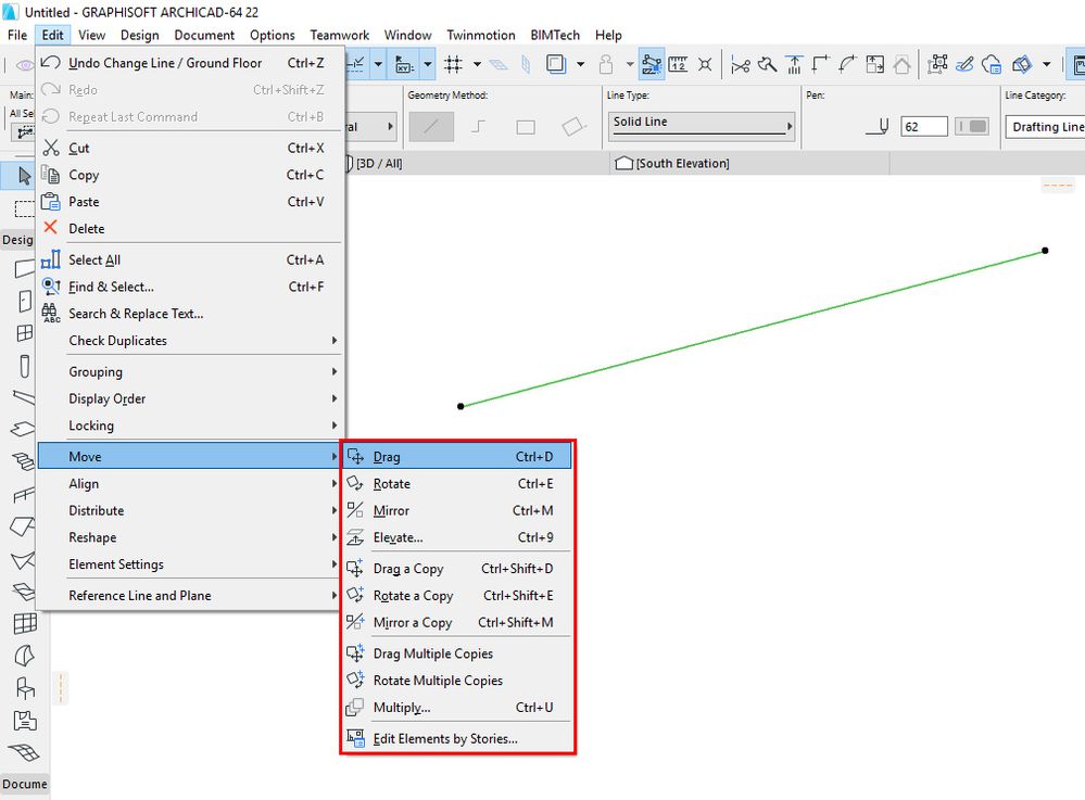

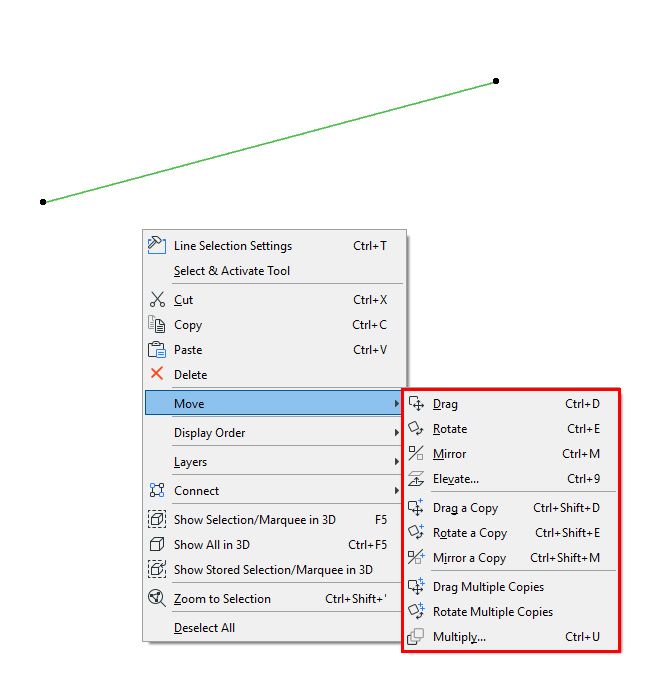

There are often several ways to start an editing command. Select the element and then
  • Go to Edit Menu: Edit > Move > Drag/Rotate/Mirror or
  • Do right-click on empty space and find the Move folder in the context menu or

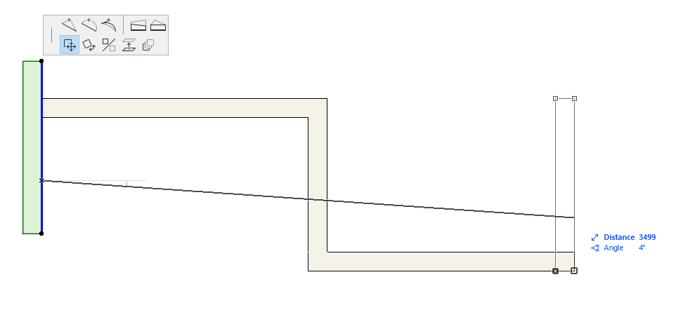

The first click defines the start point of the drag, which can be either on the element or outside of the element. We select the upper edge of the wall now. Then just click the endpoint where the element will be placed.
The moving command is vector-based which has a start and endpoint beside length and angle. You can define this vector graphically on the screen (using the mouse) or numerically by entering the values (using the keyboard).
When you start dragging the selected element, the Tracker appears immediately, where you can enter the value of the length or/and the angle.

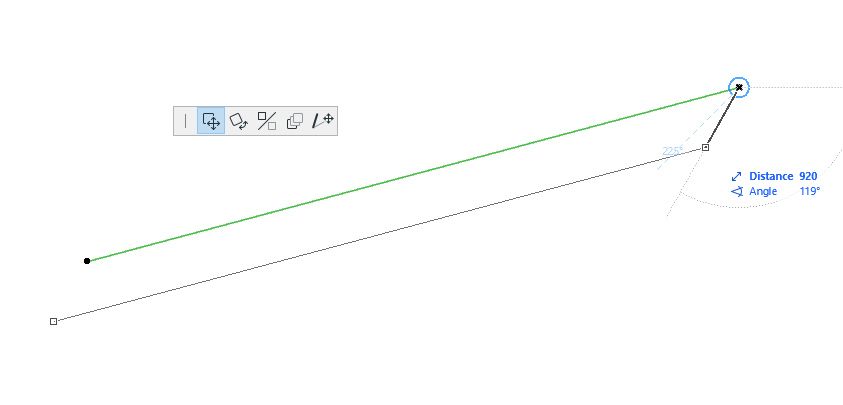

If you click on any part of the selected element again, the Pet Palette appears. The pet Platte gives you quick access to all the commands which is possible to execute. Within the Palette the “Drag” command is also available.
First, select an element and then select the following icon from the Pet Palette to start the drag:
From now on, the drag works the same.
NOTE: The available commands in the upper row depend on the selected element and point/edge you chose to open the Pet Palette. The lower row always includes the commands to move the entire element.

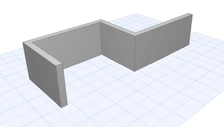

Dragging in 3D
Basically, dragging an element in 3D works the same way in 3D as it works in 2D. You first must switch to the 3D Tab and select an element.
Either select the “Drag” command at the menu or invoke the Pet Palette again. The first click defines the start point
and the second click defines the endpoint of the drag. Use the Snap Points to close the wall contour.
