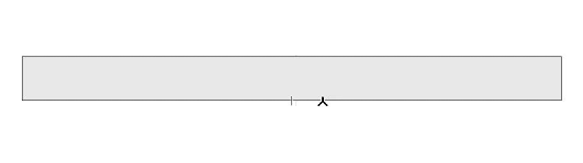

If you hover the cursor over the edge of an element, one or multiple wands (Snap Points) will appear on the element. These wands show the midpoint or a certain division (eg. third) of the element. What is shown exactly can be defined in the settings of the Snap Points.

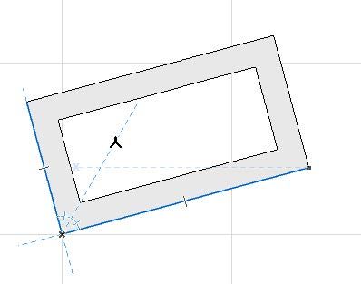

If you move your cursor over a Snap Point and you wait a few seconds (or press the Q button), that point will be marked with a blue circle. From this circle blue dotted lines, so-called Snap Guides will be aimed in different directions (e.g 45. degree, perpendicular, etc.). You can mark more than one point, in this case, you can find the intersection of the Snap Guides (blue dotted lines) coming out of those two points.

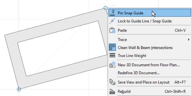

These guides are temporary and will disappear automatically after you finished the input or you press ESC.
To remove one blue marking only, hover over the line/point again.

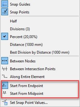

How can I change the values of the Snap Point Intervals?
  • Click on the black arrow next to the Snap References Toggle
  • Select “Set Snap Point Values…”

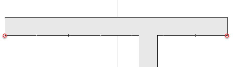

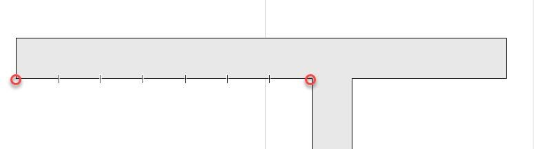

You have the option to select if the Snap Point should apply only Between Nodes, Between Intersection Points (with other elements) or Along the Entire Element
Between Nodes
wp-content_uploads_2019_10_ACE_Ch03_M02_Page_6_Image_0007
wp-content_uploads_2019_10_ACE_Ch03_M02_fills02
For the options Percent and Distance, you can select if the Snap Points should stand in relation to the midpoint or to the endpoint.

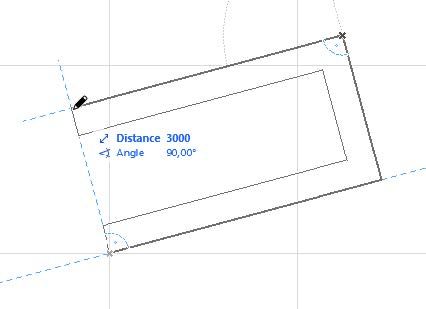

When hovering over an existing line, it turns blue and the corresponding parallel and orthogonal Snap Guides appear.
If two lines are chosen as Snap References, the angle bisecting line appears as a Snap Guide as well.
If you want to draw eg. a wall parallel to a different one, just mark the edge of the existing one boy hovering your cursor over that element. After placing the first node of the wall, the Snap Guide with a parallel sign on it will appear. You only need to follow that line, and then finish the input with a click.
