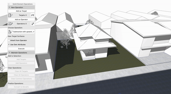

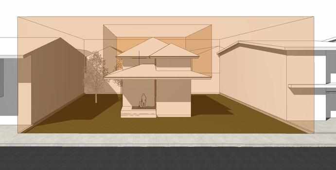

Solid Element Operation
Steve suggested leveraging Solid Element Operations (SEO) to subtract holes in a Slab (with upward extrusion), by using items in a Layer Combination as Operator, for example. Scheduling the top surface area of the Target streamlines the process of determining rainfall area.

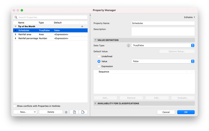

Properties are optional, user-defined data assigned to an Element/building material to provide additional searchable information about it. To create and customize Properties, use the Property Manager (Options menu). Note that Property availability depends on the Classification of each Element/material.
Properties can help you easily document total site area, including, for example, permeable and roof rainfall area percentages.
The purpose of each Property used in this demonstration is defined as such:
  • Schedules (True/False): allows our schedule to only pick the semi-transparent slab used to determine the roof rainfall area
  • Rainfall area (Area, expression): calculates the rainfall area by subtracting the permeable area from the total site area
    {Property:Slab/Surface Area of the Slab Top (Gross)} - {Property:Slab/Surface Area of the Slab Top (Conditional)}​​
  • Rainfall percentage (Number, expression): calculates the rainfall area percentage.
    ( {Property:Tip of the Month/Rainfall area} / {Property:Slab/Surface Area of the Slab Top (Gross)} ) * 100​

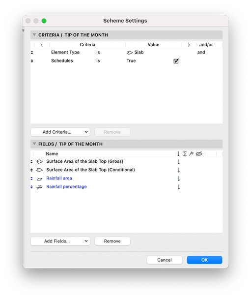

In our Scheme settings, the Property “Schedules” appears as a criterion for filtering down elements to only show the slab we are interested in.

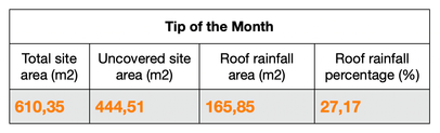

The other two Properties we’ve created appear as fields. The results of this example are the following:

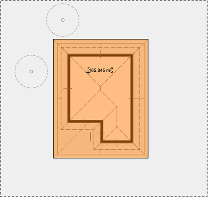

In addition to the process described above, Steve also uses fills to verify automated data:
While some manual input may be required initially, this method offers efficient, adaptable, and verifiable results.
