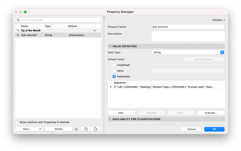

Here's how to apply it. In your Property Manager, create a Property and copy paste this expression:
IF ( OR ( CONTAINS ( "(Railing)"; {Property:General Parameters/Element Type} ); CONTAINS ( "(Curtain wall)"; {Property:General Parameters/Element Type} ) ); "Y"; "N" )
In which “(Railing)” and "(Curtain wall)” are the keywords you want to monitor. Sub-elements usually come with their host in parenthesis at the end. You can extend the expression by multiplying the “CONTAINS” function.

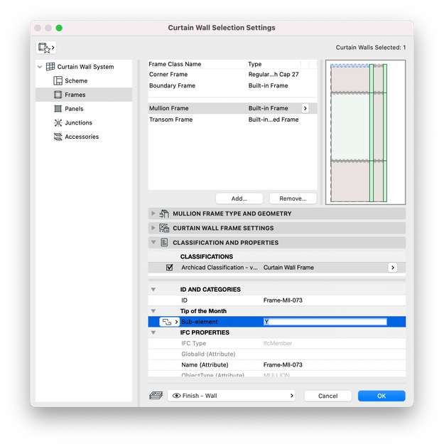

In your scheme settings, simply add this Property as a criterion:
Now, when modelling, edit your "Sub-element" Property to “Y”, in contrast to the “N” allowed in your schedule.
