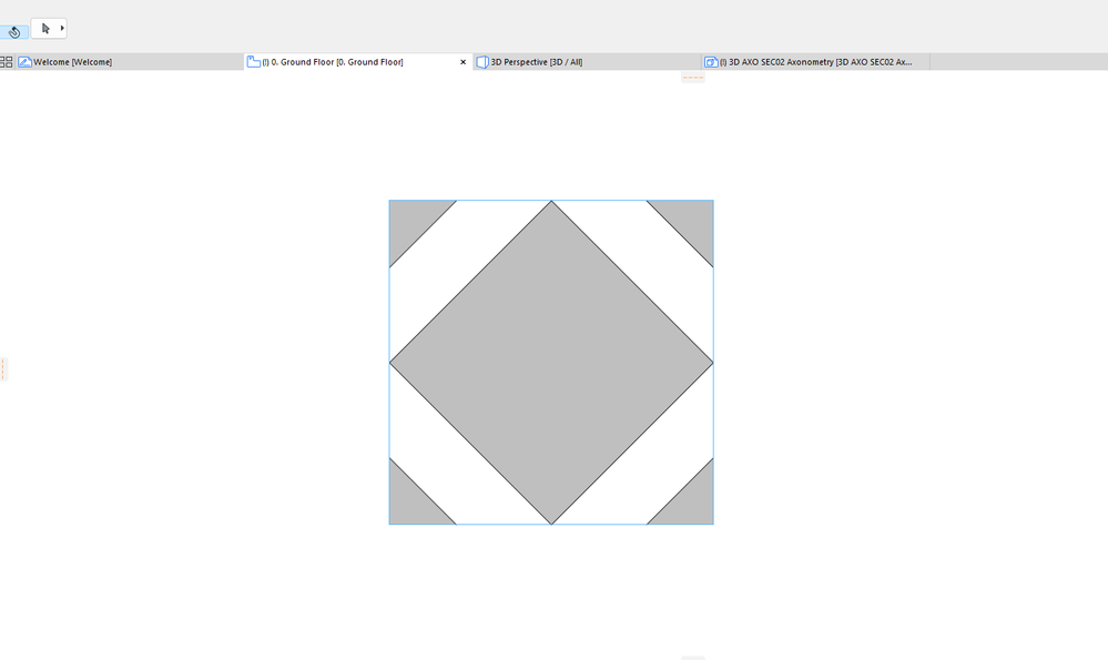

  1. Draw your pattern
    In floor plan or any 2D view, use the Fill tool (or other 2D drawing tools) to create a pattern combining Lines, Arcs, Hotspots—and at least one Fill element you want included. Make sure all elements are selected and grouped if needed.
  2. Copy the pattern
    Select the entire pattern (all lines, arcs, hotspots, and fills) and copy it to the clipboard

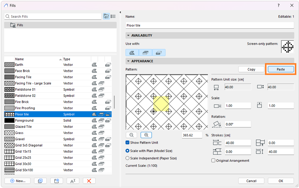

  3. Open Fill Types dialog
    In Archicad, go to Options > Element Attributes > Fill
  4. Create a new Symbol Fill
    Click New, then choose Symbol Fill as the fill type. This opens the Symbol Fill editor.

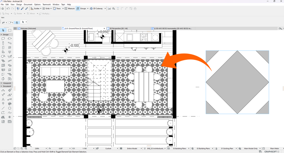

  5. Paste the pattern
    In the Symbol Fill editor’s drawing area, paste your copied pattern. The full pattern will appear.
  6. Adjust settings
    Set the Fill Pattern Pen and other parameters as needed (scale, angle, etc.). Keep in mind all parts of the pattern will use the same pen.
  7. Save and apply
    Click OK to save the new Symbol Fill. Now you can apply it like any other fill to elements in your project.
