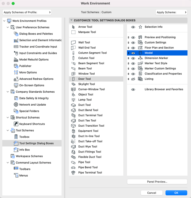

Tip of July 2023: Easily control the material of Door surfaces
We are excited to share our Tip of July, by David Maudlin. Learn how you can easily control the material of Door surfaces through two work environment tools in Archicad:
Model dialog box
Make this tool visible in your Door dialog box:
Work Environment > Tool Schemes > Tool Settings Dialog Boxes > Door Tool > make Model visible.
You will then have the Model box available and can check/uncheck the Override Surfaces option.
Surface info box

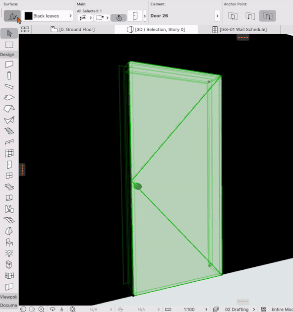

Make this tool visible in your Door info box:
Work Environment > Tool Schemes > Info Box > Door Tool > make Surface visible (or if it is visible, move it up in the list for easier access).
You will then have the Surface box available in the Info Box to check/uncheck the Override Surfaces option.
