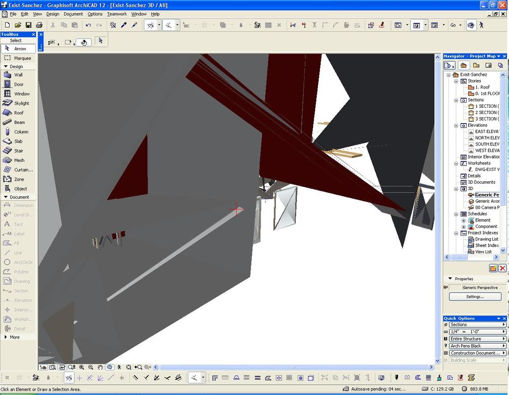

as i orbit in 3d mode...sometimes...if I get too close to the building..I get this really strange "triangles and shapes" in 3d that obviously is a graphics error........how do I fix it???

You don't specify what card or system you are using, but I would update the graphics drivers to the latest version first of all and see if it helps. Also check you haven't got any pieces of geometry a long way from the origin point as this sometimes causes graphical errors.
