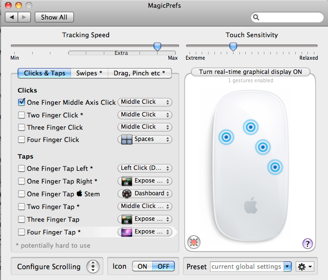

If you have defined a middle button with Magic Prefs make sure that you click it first and wait for the "Pan Hand" to show up before pressing Shift to Orbit.
These are my magic pref settings for reference.

Eduardo Rolon
Basic Magic Prefs Settings
