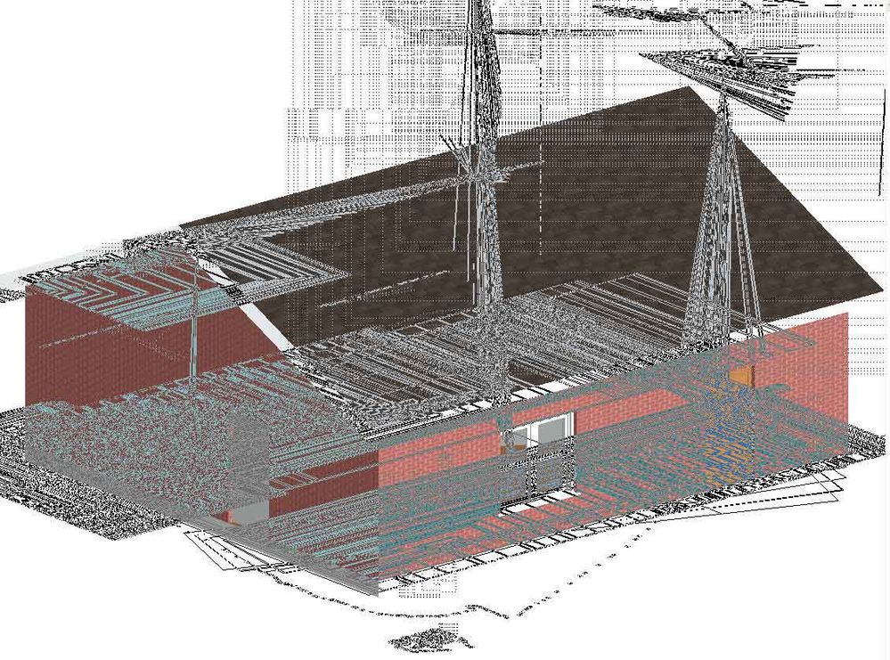

Very excited to commence using AC10, however attached illustrates my typical 3D window image. AC9 still works great in 3D. I played around with the image settings and reboots without luck. ALSO, I have no attention/warning sounds even though other programs produce sound. Any suggestions will be appreciated.

I encountered this occasionally through the beta process.
Always seemed to clear up after CLOSING the 3D window and rebuilding from scratch.

No idea on the 3D window but it looks like a graphics card issue. Is this the same with both OpenGL and internal engines? In the OpenGL engine, you might try disabling (or enabling) the "Ignore hardware acceleration" feature in the "options" of the 3D Window Settings for the OpenGL engine.

I have tried both the Internal as well as Open GL engines with the same result, including the 'ignore hardware acceleration'. This happens when the Orbit button is activated.

If you get a moment, what did you mean by "rebuild from scratch?"

Close the 3D view completely.
Reselect the camera view and "Rebuild"
see attached.

Phew! I was hoping that's what you meant. It worked in doing so! Now back to attempting to understand the new menu structure.
