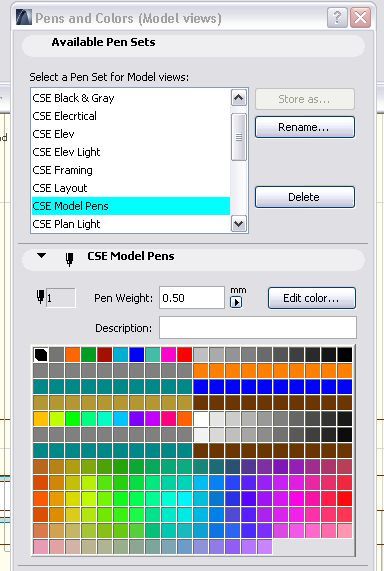

Pens set for Most of my Layouts
For what it is worth here is what I am using for my Model pen set. I resolved to use the first 150 pens from the US ArchiCAD 10 Default with most of the same descriptions and pens 151-250 I do not know where I got the designations and I am not using them at this time anyway.)

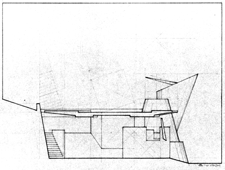

an AC elevation to show how I like to do them.

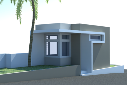

A design development rendering.
No pen sets used.
